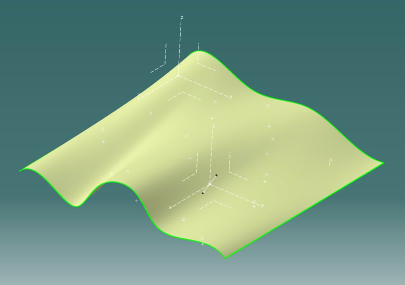

In this image I made 1 axis system on Blend.1 at projection.2 using line.2

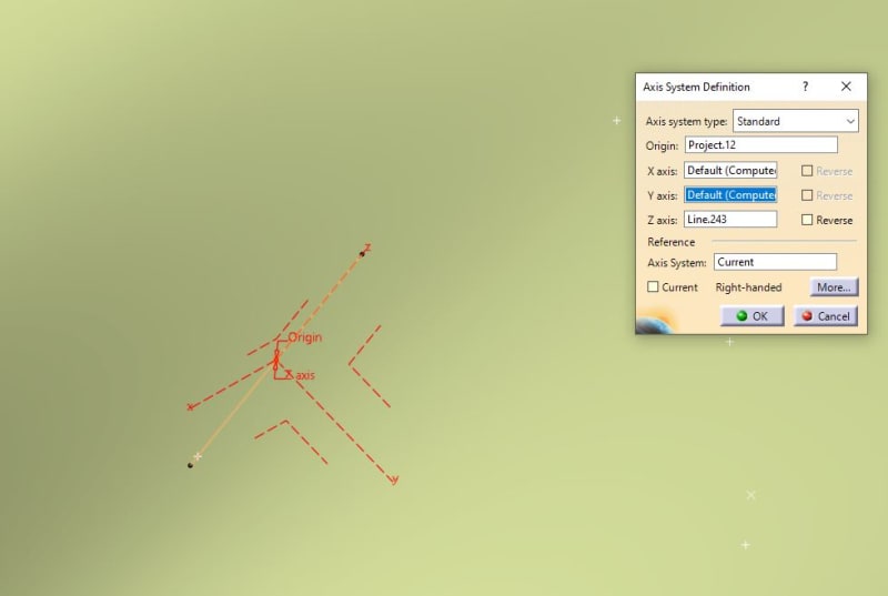

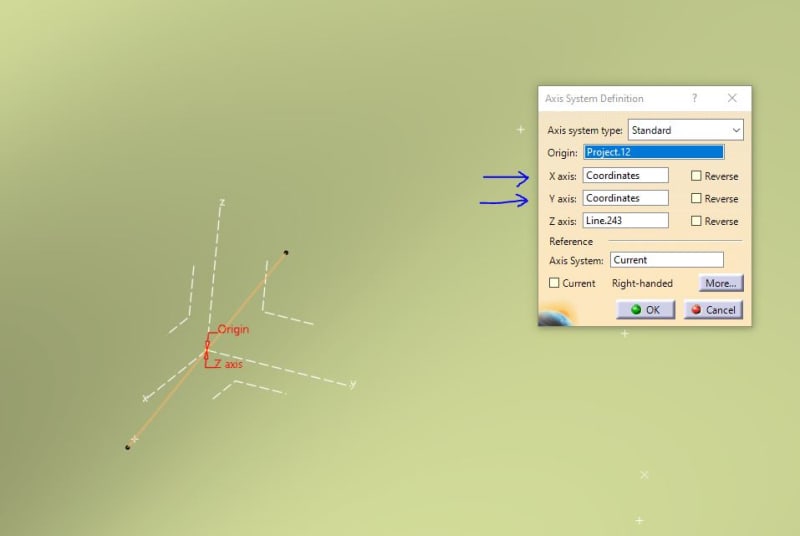

I got the macro to work up to the point it creates the Axis systems and links the Z axis to the generated normal lines.
However CATIA generates some coordinate inputs for the X and Y direction.
I've searched the internet for documentation how I can clear this selection, unfortunately I have not found the answer.
Anyone know if this is possible?
(Screenshots and code below)
Fig.1 - Generated output on one projected point.
Fig.2 - Closeup.
Fig.3 - Dropdown box, to select No Selection
Fig.4 - Desired output.

can you try to add
axisSystem.XAxisType = 0
axisSystem.YAxisType = 0
Eric N.
Legend,
This worked!
You live up to your name!
Also thanks to weagan22 for all the great assistance!

Result:

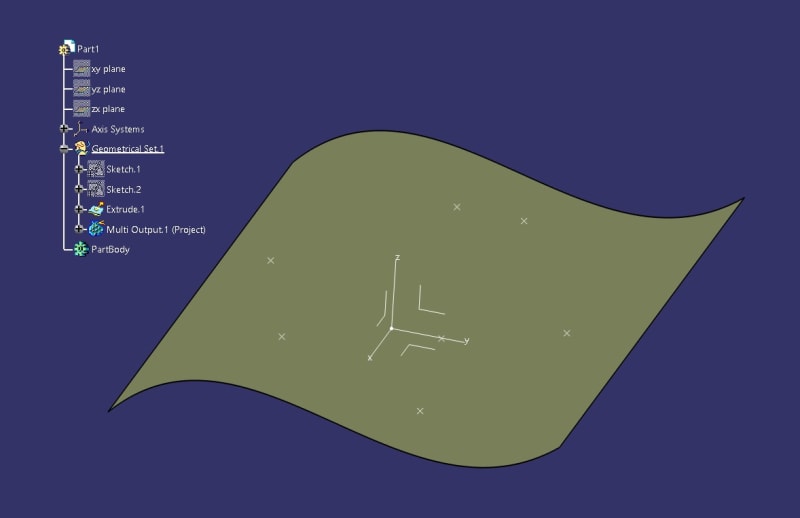

Hello everyone!
I've saved this code because it's useful for my works also.
I sketched a quick test part to examine it, however I have an error code at line 38:
InputSet.AppendHybridShape NormLine
I have currently hybrid design enabled if it matters (we're prohibited to use it though). I'm on R29 at the moment but have later versions.
Any guess on why it has a problem? I selected multi output first then extrude, and ran the macro.
