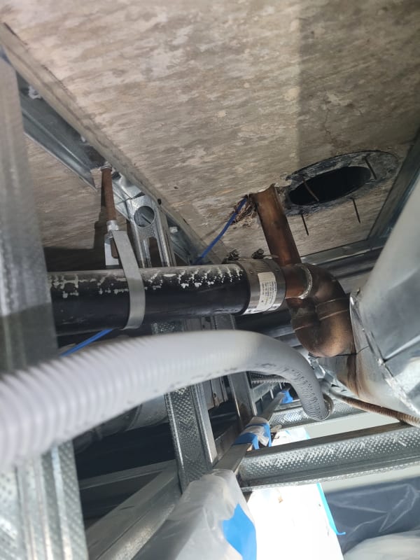

Hello,
A contractor replaced a straight supply air duct in a condo with the air duct circled in red with multiple extra bends in the air duct. Can someone confirm that this change in configuration will also change the air flow negatively and what could be consequence of changing it to this configuration? The supply air duct is attached to a Fan coil.
Thanks.

It is on the critical flow as only this duct supplis air to the whole unit and there is already a 90 degree bend coming out of the fan coil, and 90 degree bends before and after this section of the air duct before these new bends were introduced. With one 90 degree bend pretty much right after one of the 45 degree bend introduced.

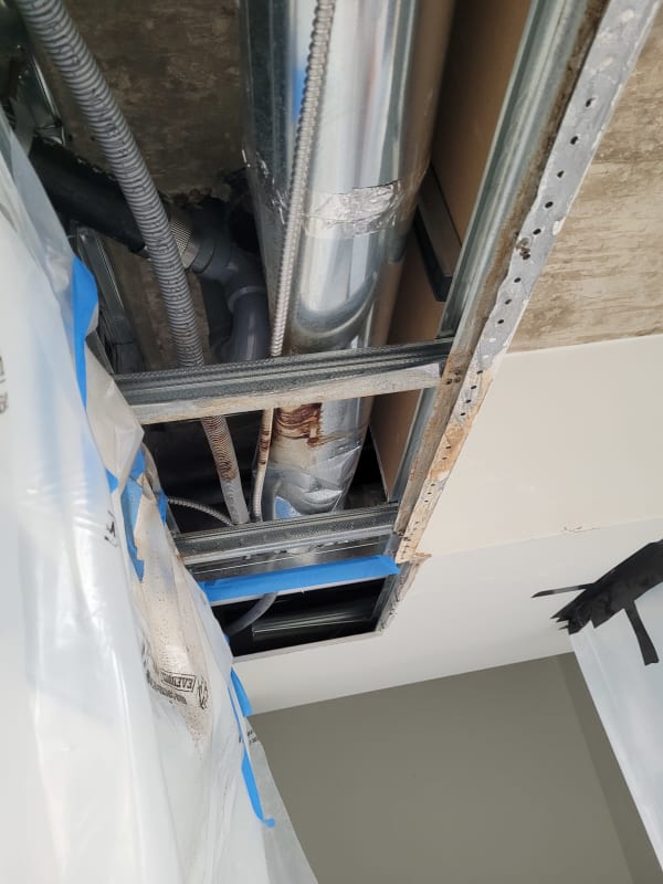

I've attached the original damaged duct. There definitely was not any coordination and I don't even know if the pipe coming straight of of the concrete is fireproofed properly.
Any advice of suggestions on how to fix this properly or test to ensure that the change is insignificant would be much appreciated on how to fix this properly. Thanks!
The damaged duct likely produced as much additional pressure drop as the 45 ells added. Two 45 deg ells add 10 feet (just approx. without looking up true values but can't be any more than this) of equivalent length of straight pipe which is insignificant considering the entire duct system may be a couple of hundred feet in equivalent length.
ESP is the static pressure that is measured between the inlet and outlet of the unit which it is rated for based on the rated flow. This is the pressure drop in the duct system external to the HVAC unit. Adding two 45 deg adds minimal amount to the ESP. For instance, most ducts are typically sized base on 0.1" w.g. pressure loss per 100 feet of length. If two 45 ells have an equivalent length of 10 feet total then the added ESP is only 0.01 inches water gage In a system that was designed for 0.2" w.g. if 200 ft. long this is insignificant. I would just observe if there is any change in cooling ability of the unit before I try to get contractor to make any more changes. Or if you are really concerned you can hire someone to get a measurement of the actual flowrate in the discharge duct and compare it to the rated flow of the unit.
For sure the new duct will be working better than the old damaged duct, even a piece of duct tape taped to the puncture in the damaged duct would have worked better. But I don't think the original HVAC design was for the pipe to come out in that spot and it was designed to be a straight duct run. I think the pipe was not installed properly. So the question is whether or not this new installation will cause less performance to the HVAC unit compared to if everything was installed properly in the first place with the pipe that would have allowed for a straight run of the air duct.
