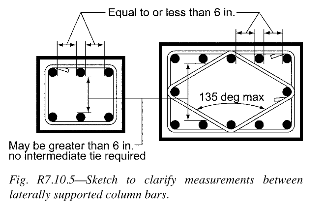

Hi all - I'm more versed in the seismic world, so I'm very familiar with the 135 degree hooks at the corners of rectilinear ties. If you are not in a seismic zone - can you work with 90 degree bends instead?

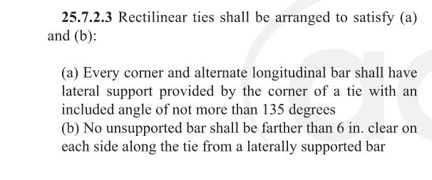

ACI 318-19 seems to suggest this - especially when looking at all the blue hoop ties in the image below(Ref: ACI318-19 Fig 25.7.2.3a). However they give the orange tie in the second case 135-degree hooks which is throwing me off.
My first thought was:
1. Orange tie does not enclose all bars - so therefore it is more of a "cross tie" than a "hoop"
2. Thus, seismic hook is required at one end per crosstie requirements in 25.3.
3. Having only one 135 hook would look weird - so make both hooks 135
But this kind of falls apart with the fourth diagram, where each hoop technically doesn't enclose all of the bars but get away with 90 degree hooks. Seems like there's a consistency issue somewhere here, but I'm nto sure what exactly is at fault.
Could I just specify 135 and avoid the headache? Certainly. But for the fun of the exercise...let me know what you all think.

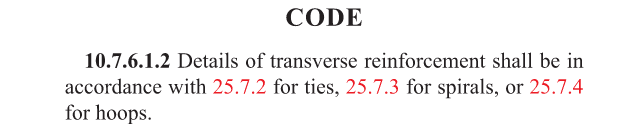

Luceid said:
haynewp - specifically thinking about non-seismic cases here. I'm more familiar with seismic detailing so this is what I'm used to as well - just curious if the standard changes outside of seismic zones. Generally seems like most people use the 135's anyways!
That's what I posted from 318-19, that's for non-seismic columns.
haynewp - Ah sorry - misread the section numbers too quickly, thought I saw a section 18 at the front! I think what's confusing about that 135 degree line in my thinking is that the 135 degree requirement there is not referring to the angle of the hooks at the ends of the bars. This is supported by the images on the following page (see the images of the first post) which all have blue rectilinear ties without 135 degree hooks at the end despite coming right after the code reference you posted.
If you go back to ACI 318-11 - they have a different image in the commentary which I think is what they are trying to get across with 25.7.2.3(a) - that the angle between the legs of the tie must be less than 135, not specifically the hooks at the ends. (See below)
What do you think? Is ACI 318 just being confusing again?
lexpatrie - 100% agree, 135's are always going to work to satisfy requirements in nonseismic or seismic territory - that's why I'm exploring this more conceptually than to pose a real change in my detailing. Makes me think that ACI should just revise their imagesto show 135's at all of the rectangular ties to settle it and move on, especially since the hook length for 90 vs 135 is the same, so the only real difference is the rebar fabricator bending a little further...
Once we have 135 on both ends, it may be difficult to actually get the cross-tie around rebars on both ends. Just visualizing the process in my head, a 90 bend on one end will make the process much easier
Luceid, I think you're right but even the CRSI has 135 deg alternating hooks on their standard column detail. The details that come with the ACI detailing manual also show the 135 deg hooks at one end on the internal ties for typical columns. I think I have always seen it that way.

Since the diagrams you first posted have "crosstie" called out at the interior ties and a "crosstie" is defined by ACI below, I would go with the diagrams for non-seismic including where the 90 deg bends are shown. This also matches the other references I found.
But I think their intent should be clarified in 25.7.2.3 paragraphs (a) and (b) to match the diagrams use of a "crosstie" with the single ended 135 deg (seismic) hook at the interior ties. But I wouldn't change what appears to have always been used anyway even if the word "crosstie" does not appear explicitly in paragraphs (a) and (b).

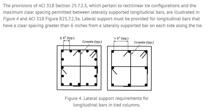

I think in SDC C and below it's typically a 135 on one end and a 90 on the other. I also wouldn't call them "seismic" 135 degree bends. They seem to require a 135 degree bend on the the one end in all situations.
Source: Fanella, Structure Magazine, 2019 (see link in previous post).
As side note, higher seismic the vertical bar splice locations shift from bottom of slab to middle of column height.
The word seismic maybe doesn't belong but it is coming from the ACI definition of a crosstie.

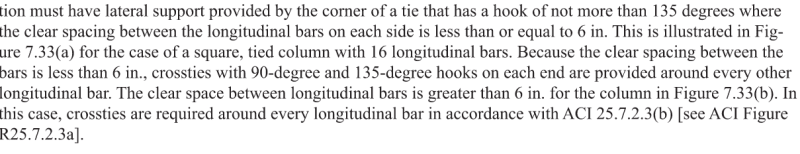

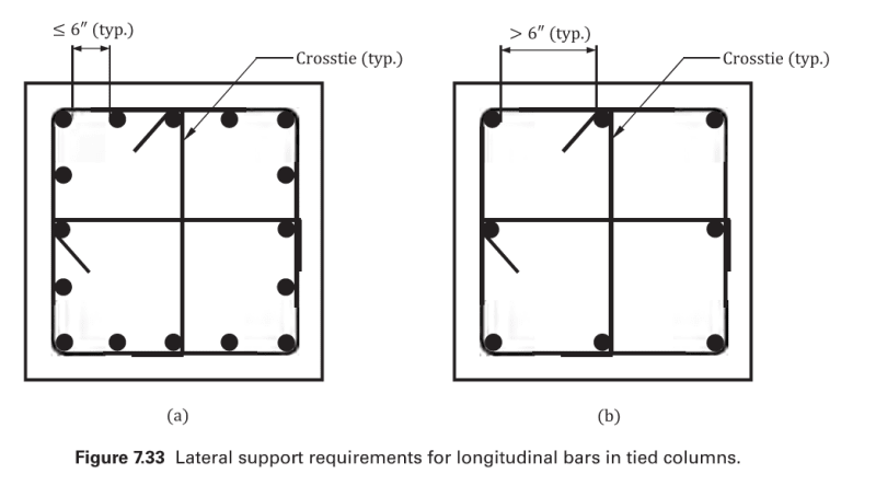

I'm not sure where the above came from, but the below is from the CRSI Design Guide to ACI 318. It looks like the detailing diagrams from ACI 318 in the original post with no 135 deg hooks at the corner longitudinal bars.
