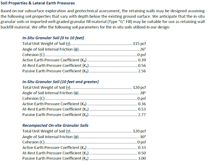

My current issue is I am doing the internal stability for an MSE wall, and the global analysis performed by others used FOS=1.5 (rightfully so based on literature and 2H:1V toe slope, supporting a 3-story building 15' back, and 26-degree foundation). But I am scratching my head at 42' grid lengths with a 14' exposed height and 5.5' of embedment. The owner is asking if there is any way to decrease the excavation. I have confirmed the global stability factor of safety is right at 1.5 with these variables. I wouldn't propose using a lower FOS unless I could find justification for it. I have been playing around with embedment and undercuts with not much help. Unless there is a convincing reason to use FOS<1.5, I do not see an alternative (with the current wall type and without other ground modifications which are beyond my expertise).

The soil properties are from a geotechnical report with recommended friction and unit weights for two layers of soil under the wall. The upper layer is 26-deg and 120 pcf for 10-ft and the lower layer is 28-deg and 115 pcf.
Using sands in the reinforced zone and the recommend values for Ci and Cd from the Synteen literature.

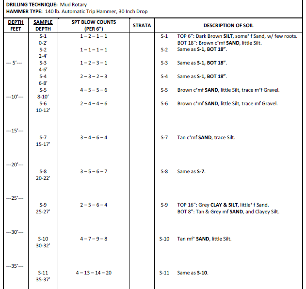

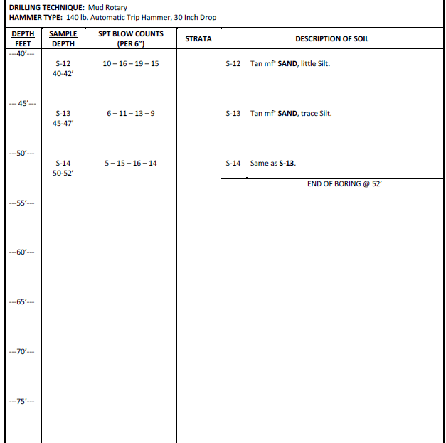

That said, I’m interested in what the soil conditions are at this site where the friction angles are so low. LOTE can you provide a boring log redacting the project and geotechnical engineer?
I ran the existing condition (based on recommended soil properties) and got a FOS = 1.04.
Here's my two cents: If you use parameters back calculated or that imply a Static FoS of 1.0, with a long-term static groundwater condition, then you will always end up with an extremely expensive wall regardless of what type of wall is designed. IME it will also be incredibly costly to try and achieve a global FoS of 1.5 instead of 1.3. If, however, you use parameters derived for 1.2 - 1.3, then a forward calc using those parameters should achieve 1.5.

Considering the blow counts are from an automatic hammer, only the first 8’ are relatively low. I would say the top 8’ is loose and would conservatively warrant a 28 degree friction angle, followed by 32 degrees for 8-30’, and 34 degrees for >30’. I’d start there before fiddling with the soil properties and wall geometry more if it was my project.
The top 8’ could be excavated and recompacted to increase the friction angle to 34 degrees.
If I’m still having problems at that point, I may be looking to go in a different direction.

For liability, I would not go and use higher friction angles than what the geotech recommended in their report. I try to stay away from proposing soil properties whenever possible.
If a geotech recommended those values in my area, they could be argued with. If I had the client's ear, I would recommend the owner never hire that geotech again, as they are costing them money and probably preventing projects from ever being constructed.
This is based on the very limited information I have. That doesn’t mean there isn’t a reason for the very conservative values. As geotechguy stated, if there are many failures in the area, the geotechnical engineer may need to provide highly conservative values to avoid loss of property or life.
If you can't get the geotech to revisit it then you are dead in the water. The grid lengths I think make sense based on the parameters provided, you are trying to achieve FS = 1.5 from a condition of FS=1 with low parameters so you will end up with long grid lengths.
