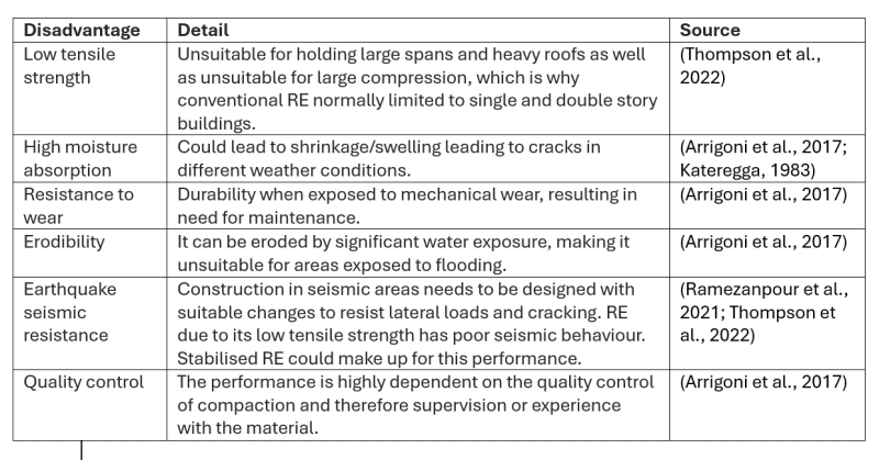

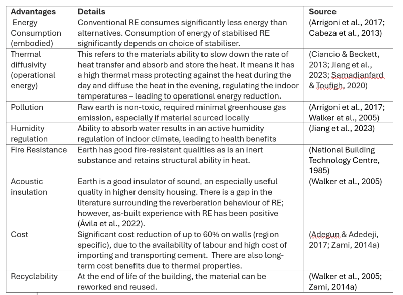

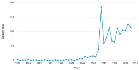

Having spent a lot more time on this now, there is an incredible body of research out there on Rammed Earth. I have attached the Scopus literature analysis of just Rammed Earth research going on, so not including all the other types of earth construction methods.
Unfortunately, earth construction has this 'traditional' or 'weak' stereotyping attached to it, because the recent construction work is very much a Modern Method of Construction. Really hope more lecturers and technical programs get more familiar with this work as it seems to be a win economically, as well as environmentally and considerably improved thermal comforts and fire resistance. Can see places that are exposed to frequent wildfires adopting this more over the next few years.
There is a (I hope) useful summary of all the technical aspects I have found in the Advantages and Disadvantages. I may have geeked out on rammed earth a bit over the last few months.

Just a note on the disadvantages - the majority of these weaknesses can be overcome with appropriate improvements in design and technology such as chemical stabilisation (lime or cement - these just effect recyclability of earth), wear protection (many modern coating options - linseed oil, paint types) or appropriate architecture and construction processes.
Thought it is worth noting that there are easy ways around the disadvantages
