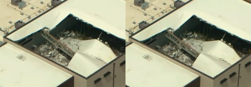

An interesting looking truss. How bad does your design have to be to mess that one up? It looks like a rather basic clear span done every day. I guess we can estimate the span off Google Earth.
Edit: Maybe not a basic design. Two girders carrying the trusses and ne of the girders collapsed. Possibly the bearing surface of the support column was inadequate.
Wow! Brand new, no snow/ice/rain load. Someone messed up big time. Maybe overlooked a critical buckling mode.
From the video, it looks like the trusses weren't even attached to the girder.

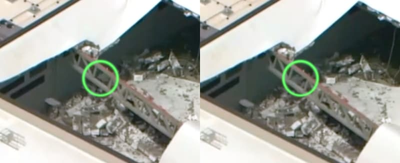

There's a missing web element in the girder.
Edit: re-centered, white balance and brightness enhanced

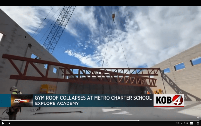

From in-progress, 2:15 in news video:
Indeed, that missing diagonal could be a cause.
The truss could have easily been designed for not having that diagonal for mechanical reasons, or whatever. There does not appear to be any distress in the area of the missing diagonal.
I cannot determine the type of framing. Was it long span trusses? with smaller short span trusses framing between. It appears the long span trusses have steel columns at the ends for supports. It appears to be a failure of the support attachment... but just a WAG.

Just a first blush impression - the large truss bearing failed and dropped one end of the truss. Pulling the adjacent bays on either side down with it.
The other large truss bearing didn't fail and thus the 1/3 of the roof stayed put.

On the "missing" diagonal- both trusses, both ends are like that, so looks pretty intentional.
Ok, not my field, but you don't need both chords of that style of truss to be separately supported, do you? A diagonal member from the unsupported chord to the supported chord serves the same purpose, doesn't it? The floor trusses for the original WTC 1 & 2 were only connected on the top chord, for load bearing purposes (there was a damper to the bottom chord), similar to the trusses seen here.
