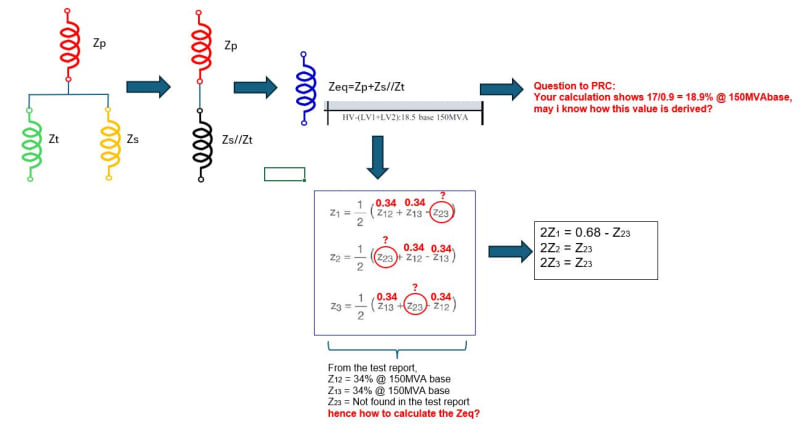

Dear PRC,
Referring to your reply , I'm lost in this part:
HV-LV1+lV2 impedance will be 17/0.9 =18.9 % on 150 MVA base.
Please assist.
powerven
When both the LV1 and LV2 are loaded, the impedance offered by the transformer is 18.9 % on a 150 MVA basis. I have used the thumb rule to arrive at this figure.

The formula is applicable only for axially split LV winding arrangements ie loosely coupled LV windings.
Dear PRC,
Referring to your calculation, below are my further queries related to the numerical derivation:
Your guidance is appreciated.
powerven
The factors are not derived units but from observing the impedance pattern in similar transformers. You will find Z1 almost zero in this type of transformers.
