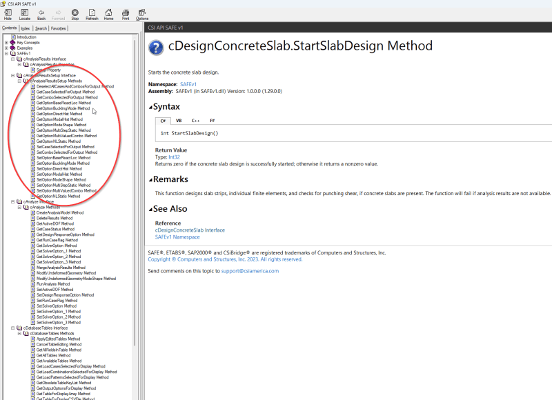

I have a significant project that would require us to intensely use SAFE/Etabs to analyse and design slabs/walls for the structures and I are keen to understand if there are functionalities that allow us to complete the design of a slab within CSI Etabs/SAFE.
I am interested in extracting the rebar area information in units of mm²/m. My aim is to utilise this data for further processing from excel and the to our auto drawing generator tool.
Is that possible? I can seem to find the option in SAFE/ETabs to export the FEM based Rebar Area Contours.

Thanks for providing this file DavidAtkins. I am trying to use the API feature through C# language to see if I can extract the FEM results. However, my SAFE free version does not support it currently. Would be curious and happy to take a look at it on your PC, if that works, through zoom or teams during the weekend - seems like it might work but cannot guarantee - will have to dig a bit deeper and get hands dirty (also because it's a significant project for you).

I do not - I need to look at the documentation for SAFE and see what API functions they provide first and what arguments these functions need. I do not have this documentation.

After a quick review of the API for SAFE, I do not see anything immediately available that would give access to contour plot type results like rebar densities.

DavidAtkins, unfortunately SAFE/ETABs lacks a bit on post analysis results and rebar results, see this eng-tips post here:
Do you have access to RAM concept? RAM concept is easier to extract rebar results and data. You can write a few custom tools to send this data to documentation like Revit for drawing automation.
S&T
