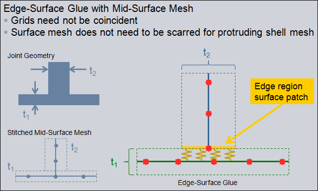

i was modelling the glue connection for a windshield.the thing is i want to run a non linear glue contact analysis. since i dont have a license for that i planned to connect the matching glue contact mesh region with RBE2 elements. what do you think about this approach and how accurate is this approach ?
Bad, very bad meshing approach. RBE2 elements should be used as the very last resource.
BASIC NONLINEAR (SOL106) is part of BASIC NASTRAN, then is included in your license.
By the way, Glue effect is not supported in nonlinear analysis (SOL106):

hi Blas , thank you for your response. But glue is essentially rigid connection, if i model all my connection region with glue elements the behaviour shouldnt change right ?
yes SOL106 doesnot include the effects of glue , so that was the best approach i could think off
Hello!,
But RBE2 elements moves like a rigid element, the coordinates are not updated in a nonlinear analysis (SOL106), this is the main limitation with SOL106.
The modern Nastran Multi-Step NonLinear (SOL401) support RBE2 elements for large displacements effect, updating it coordinates during iterative analysis.
In summary, for SOL106 better use any element different to RBE2 rigid elements, you can play with CBAR/CBEAM elements with reasonable cross section.
Glue is a simple and effective method to join meshes which are dissimilar. It correctly transfers displacement and loads resulting in an accurate strain and stress condition at the interface. The grid points on glued edges and surfaces do not need to be coincident. Glue creates stiff springs or a weld like connection to prevent relative motion in all directions.
