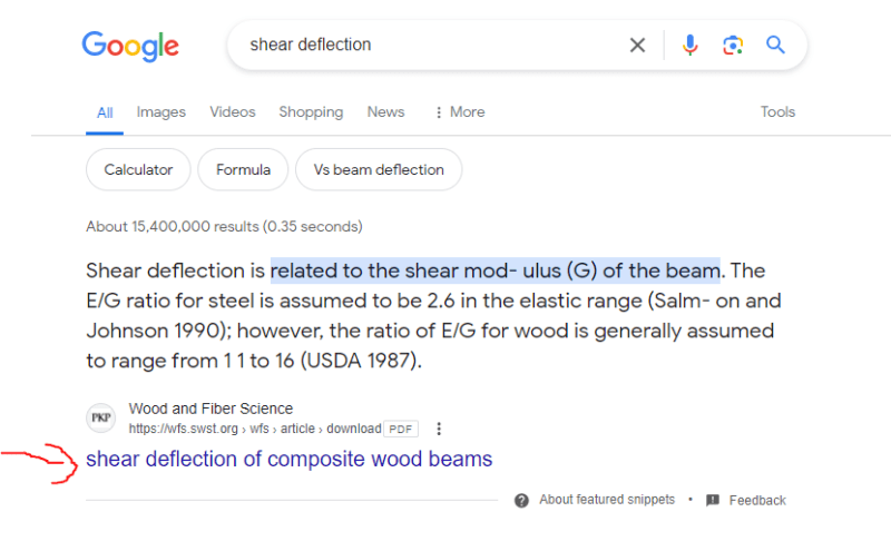

Don Bender has a research paper that discusses a bit of the derivation and how to approach, I'll include a photo below of how to find it.
This text on Timoshenko Beam Theory covers most loading conditions: Link
The tricky part may be determining what the shear area is for the SCL, you could likely back into a possible solution using the manufacturers listed equation.
