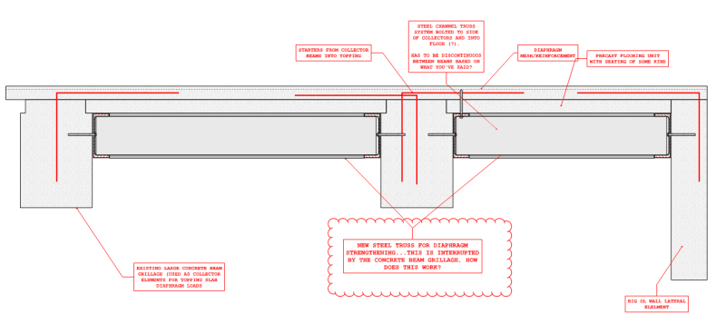

How does that placement work? Presumably if your truss is at the underside of the slab then it is discontinuous at the beam locations?
Agreed that I would ignore the eccentricity if it was only 30mm or so though
Green-
the load transfer originates from the bracing elements above the basement -> into the conc big beam line as a collector -> unloads to PFC channels which are epoxied to heck to said all conc collector beamline (all the bays are trimmed with PFCs in this zone) -> gussets from field installed PFCS with site welded splice plates to said collectors) -> gussets to comically large tube horizontal diaphragm bracing

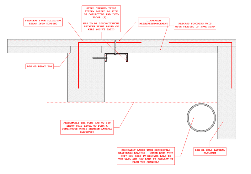

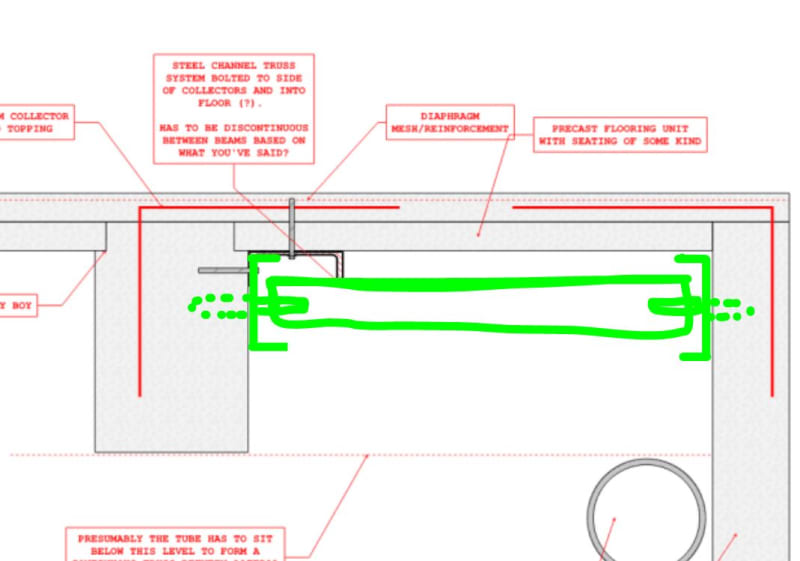

See my sketch below - how does this all work?
there's details like the slab on left side of beam is very thick with real reinforcing... it steps down to the very shallow topping with poo poo mesh.
But the new strengthening bits are in green.
Ok so the PFCs sit in at that line...how does that work when there are multiple bays of beams between lateral elements?
The trusses run down the entire length of building (into the page of your sketch).
In-plane diaphragm shear transfer through the diagonals.
The associated T/C resolved in the big beams.
think of a long braced frame elevation but tipped over on it's side...
Oh right, so the trusses are only effective for diaphragm strengthening in one direction then?
