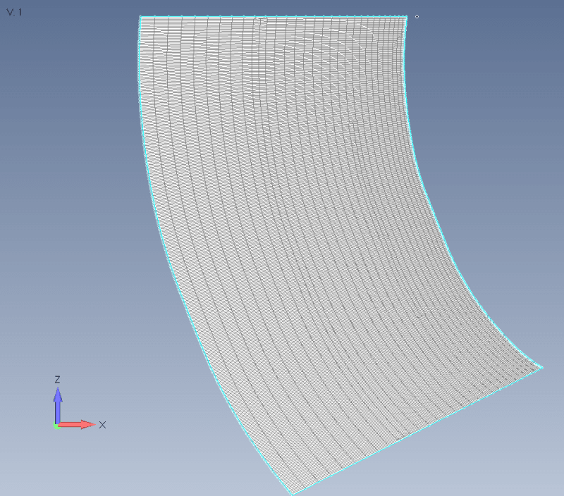

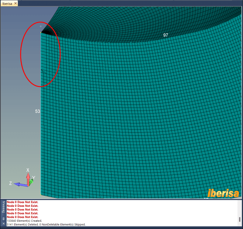

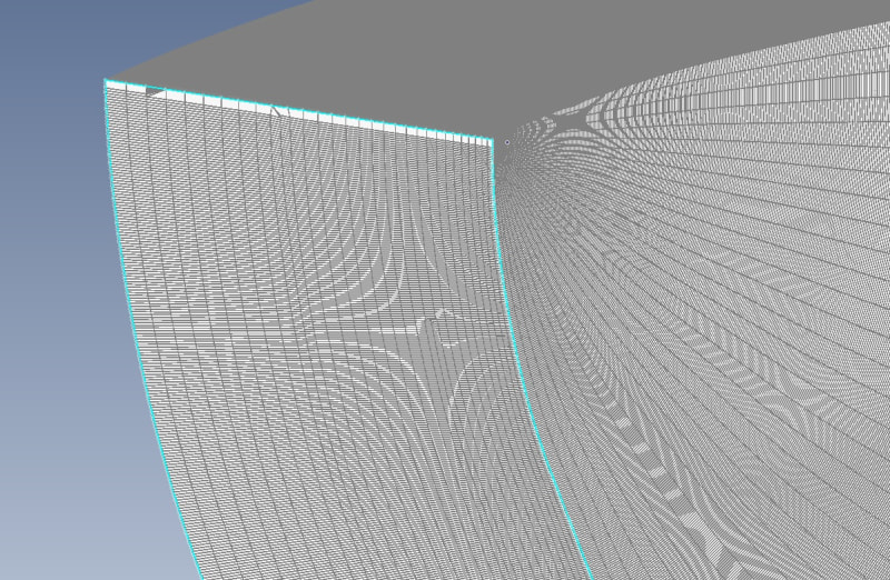

I have been trying to create a body of revolution in FEMAP but I am having issues with small cells when it is near the axis of revolution. This is shown in the attached figure where the top rows of element are somehow merged. Does anyone have a good solution for this or know why it is happening?
As further information, I know the elements wouldn't be great for structural modelling, but I am intending to use the mesh for aerodynamics.
Ian

It is very strange as if I only export the region where I am having the issues as a .neu file and then read it in, the revolve works but if I export the whole model it doesn't. When I run the revolve command is says "Node 0 Does Not Exist" lots of times as a warning message.
The modfem with the error is attached.

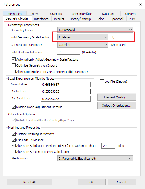

Try to create new model. On empty model before any geometry import/creation go to File->Preferences->Geometry/Model and set scale factor to meters.

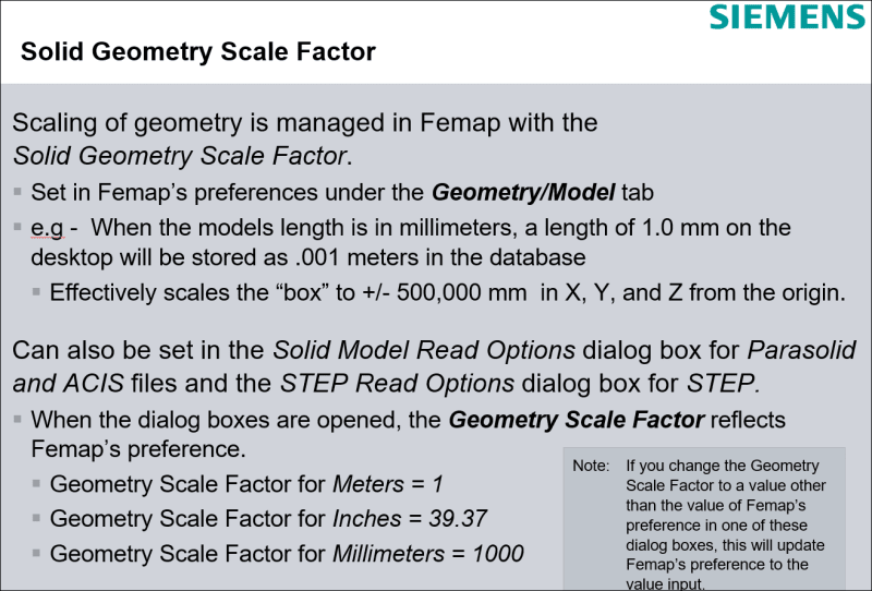

• I strongly suggest to work always in millimeters to avoid meshing problems related with tolerances: is something hard-coded internally in the mesher, when meshing in meters with element size = 1 mm is 1/1000 = 0.001 meters, and this could cause a problem with the tolerances used internally by the mesher.
When I open your FEMAP model I see the following warning message: this means that your model is using different geometry scale factor than me, I run millimeters.

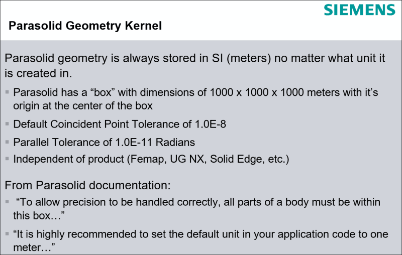

• Second: check if the model is outside of the Parasolid BOX, if yes you will have problems like the one reported.

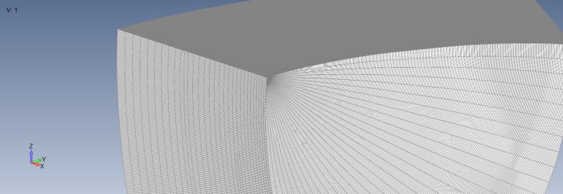

@Thomas the bit that I show in the figures is just the top of this panel plus I have deleted the panel behind it. If you try revolving the mesh around to (0 0 0) to (1 0 0) vector by 90 degree with 30 elements around the sweep length you should see the same issue where the mesh near the axis distorts itself.
@Blas. I think you are correct that it is a numerical issue with the rounding. I tried deleting the geometry and repeating the revolving process as described above and it seems to be fine

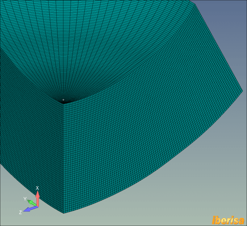

If I perform the MESH > REVOLVE > ELEMENT command following your indications I get the following result:
Next, I will UNDO the REVOLVE command and DELETE ALL EXTRA POINTS (10 points deleted).
If I issue the TOOLS > PARAMETERS command I will see the following: merge tolerance is recomputed and the new value = 0.0236 mm
If I repeat the MESH > REVOLVE > ELEMENT command the result is the following: the generated mesh is perfect!!. Not any warning issued of "Node 0 does not exist", all is perfect.
In summary: the model dimmension is important, if affect the merging tolerance, a key fator for both meshing task and geometry operations when performing intersections between surfaces or boolean operations with solids, OK?. Alwys take a look to TOOLS > PARAMETERS command, remove extra geometry that coul affect the performance of the FEMAP model.
