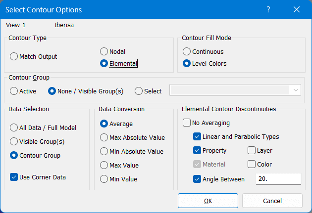

I was performing some post-processing in solid elements, around a hole to be more precise. I had an issue with a high local stress.
A more experienced colleague told me that I was using "Average" for the result output and that I should use (it is what he does) "No average, Centroid Only".
By doing this the stress shown in the solid element passed from 600 [MPa] to around 240 [MPa].
Next, I did the same with plate elements, but the stress (MaxPpal) increased.
My question, therefore, is : How does it work with plate and solid elements ? I mean it seems counterintuitive that by no averaging the results, the output is higher.

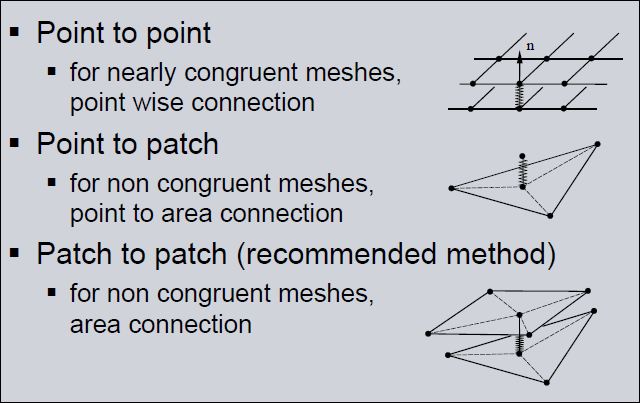

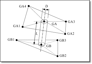

In fact, the CWELD is basically a CBEAM element, with useful features:
My favorite method is PATCH-to-PATCH: you don't need congruent mesh!!.

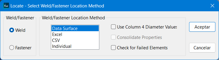

And you have the grea API from FEMAP team: CUSTOM TOOLS > MESHING > WELD-FASTENER ELEMENT GENERATOR: fort the bolt location you can create an EXCEL file with X,Y,Z + BOLT DIAMETER, or a DATA SURFACE internal in FEMAP, and automatically FEMAP will do the job!!

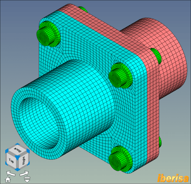

This is a picture of a FEMAP model of a bolted flange I am running just now.
According the NASTRAN manual:
"The CWELD element let you establish connections between points, elements, patches, or any of their combinations. Although there are a number of different ways to model structural connections and fasteners in Simcenter Nastran, such as with CBUSH or CBAR elements or RBE2s, CWELDS are generally easy to generate, less error-prone, and always satisfy the condition of rigid body invariance".
You can list CWELD forces using LIST > OUTPUT > FORMATTED, then you can check if the CWELD pass or not any bolt checks according to AISC (ASD) 9th edition, for instance, OK?. Enjoy!!

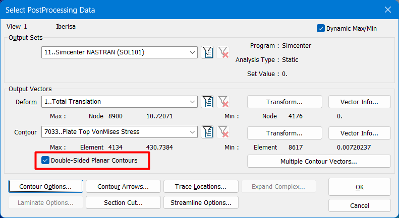

Ah!, regarding postprocessing stress results:
• Nodal stress in solid elements: if the mesh density is correct (not coarse or highly distorted) the nodal stress is a correct result. But please have in mind: if the node location is singular, not matter you refine your mesh the nodal stress will be higher and higher. In this case to demostrate that the stress result is convergent (mesh undependent) use another location at a near distance of the singular point.
• Nodal stress in shell/Plate elements: well, here I always use the following options.
- Contour type: elemental. Yes, because if you have a node that is shared by two shell elements of different thickness or material you can understand that is not correct to "average" nodal stresses, is not correct. This is the reason why in some cases nodal streses in shell/plate elements are smaller than centroidal elemental stresses.
By the way, to get centroidal-only elemental stress you need to set ON the option "ELEMENT CONTOUR DISCONTINUITIES = NO AVERAGING", and set OFF the option "USE CORNER DATA".
In my case with CONTOUR TYPE = ELEMENTAL I set SMART AVERAGING because I use "elemental Contour Discontinuities" is not activated, excepts for the options property, material or angle above 20º, OK?.

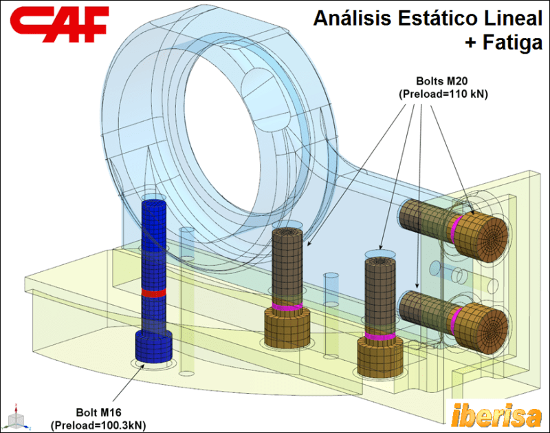

BOLT PRELOAD: yes, this is an important limitation. In reality, all bolting joints are preloaded, then you can imagine. But the CWELD connector is of inmediate application, easy to mesh, fast, thanks to the FEMAP API, and more accurate than the cbeam + rbe2 spider elements, not comparisson.
In any case, if you want accuracy + bolt preload you always can study the joint using solid elements, visit my blog:
• Connecting more than 3-layers of elements: The patch-to-patch connection can also be used to connect more than two layers of shell elements. For example, if three layers need to be connected, a second CWELD element is defined that refers to the same spot weld grid GS as the first CWELD. Patch B of the first CWELD is repeated as patch A in the second CWELD.
• CWELD elements are not supported in material or geometric nonlinear analyses.
• Limitations in area:
[ul]
[li]Patch-to-patch connections are recommended when the cross sectional area of the connector is larger than 20% of the characteristic element face area.[/li]
[li]The patch-to-patch connection is sufficiently accurate if the ratio of the cross sectional area to the surface patch area is between 10% and 100%.[/li]
