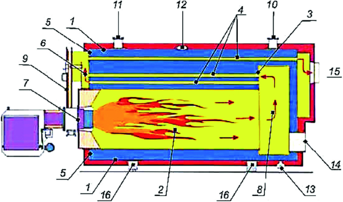

Thank you for your reply, Pierreick
Fired Heater is just like Water-tube boiler.
The construction of Fired Heater is totally different from that of Fire-tube boiler.
(For Fired heater, Flame is outside tubes.
But, for Fire-tube boiler, Flame is inside tubes.)
See Fire-tube boiler construction as below.
You're looking for an indirect water bath heater. I've looked previously and generally most information is empirical or CFD - you're not going to get a step by step guide on how to design on. FireCAD is commercial software which can do Fire Tube boilers in hot water only service as well.

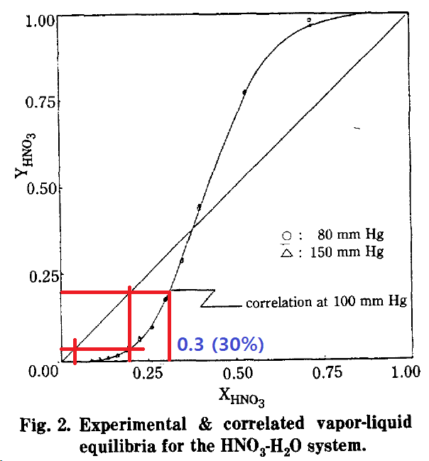

Nitric acid solution needs to be treated in Distillation process.
Nitric acid is to be concentrated by 30%.
Thanks to feature of Vapor curve of nitric acid,
From Top of distillation tower, Pure steam will come out.
My plan is to insert Fire-tube boiler into bottom of distillation tower.
So from column bottom, you have a reboiler operating with approx 0.3 mole fraction HNO3. Do you have a "once through" reboiler, or is it a forced recirculation type reboiler or a natural thermosyphon type reboiler. Only for a once through type will the exit temp from the reboiler match this VLE curve at 0.3mole fraction HNO3. For recirculation type reboiler, reboiler exit temp will be much higher. What type reboiler do you have, and is the column operating pressure similar to that for this VLE curve ?

So what is your heating duty? Do you know what exit temp is required, and has this exit temp been verified by process simulation for the type of reboiler you've got ?
If the heating duty is small, an electrical bundle heater in a kettle once though reboiler is also an option - no risk of hot spots like you have for direct fired small heaters.
I see from the internet you are operating close to the azeotrope point for HNO3-water.

A kettle type once through natural circulation reboiler is from a process design perspective, a safe design since the return line is not 2 phase vapor liquid which is prone to errors in pressure drop estimates. Also a wide turndown in flow to the column is possible since 2 phase flow turndown problems in the reboiler return line is avoided.
Think you may have to avoid any forced recirculation reboiler configuration since the column bottoms composition is close to the max boiling azeotrope point.
