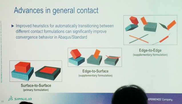

It might be better to use beam elements and general contact. In recent versions of Abaqus, GC can easily handle contact with one beam inside the other.
