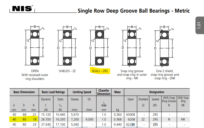

This is the specification for this bearing, seems strong, considering it has 2 stacked bearings on each side (left side - 2 bearings, right side - 2 bearings.)
It does not appear to me there is any room allowed for the bearing to climb over anything. This would be in keeping with the need for resistance to any vertical movement at the base of a scissor lift link.

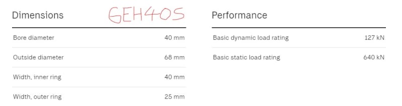

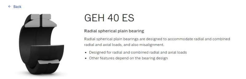

Will this be an acceptable design for the scissor lift? There is a 1mm gap for the plain bearing.
[URL unfurl="true"]https://res.cloudinary.com/engineering-com/image/upload/v1709861441/tips/Drawing1-Layout1_rfiiup.pdf[/url]

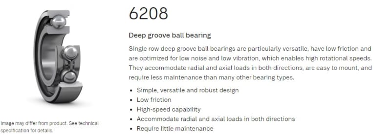

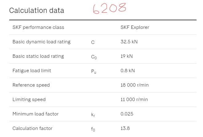

As for reading bearing load capacity:
6208:
Static Load Capacity: 19kN
Dynamic Load Capacity: 32.5kN
GEH40ES:
Static Load Capacity: 640kN
Dynamic Load Capacity: 127kN
Is it alright to directly assume that the plain bearing has a "640kN / 19kN = 33.6 times" static load capacity compared to 6208?
And, i always hear people say "how many kg can this bearing handle?". How to actually know the radial load a particular bearing can handle? It's not just purely converting kN to kg from the static/dynamic load right?
