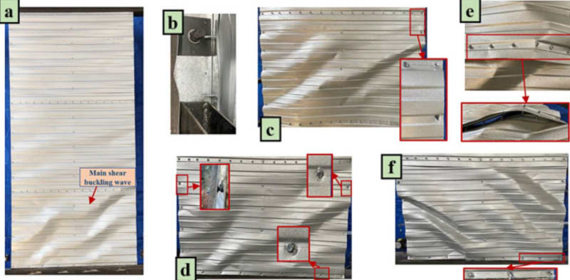

The key to understanding this is to recognize that the members supporting the deck need to restrain a shear buckling mode of failure as shown below. Every support, with appropriate fastening, reduces the length of the potential buckling wave and, therefore, increases capacity with respect to shear buckling. Translating that to your specific questions:
OP said:
Would it be the deck span spacing (5'-0" in my example image) or 30' in my example image?
The 5' deck span.
OP said:
So for a diaphragm 3'x80' in plan dimensions, where the deck spans the 3': Would you use 3' joist span in the tables for calculating the diaphragm shear strength?
Yup.
Note that:
1) By the book, corrugated deck cannot resist axial loads perpendicular to the flutes that would fold it up accordion style. You have to distribute those loads out to discrete diaphragm framing members somehow.
2) You can deliver axial loads to the deck parallel to the flutes. And folks often do. This probably does create some degree of interaction between axial load buckling and shear buckling but, to my knowledge, that is not commonly considered and we don't have a robust means of checking it.
As with most things in structural engineering... one does what one can.
Kootk, would you be willing to share the source for those photos? Appears like it could be an interesting read.
KootK can you tell me where you got those photos?
Sorry for the delay. Yeah, that was just some GoogleFu to find some photos that looked like what I had in mind. I know, not very satisfying.
