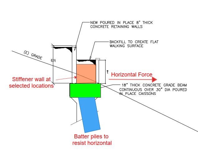

I have been hired to design the retaining wall system for a hillside residence. Basically the owners house sits about 20ft behind the top of a 2 horizontal to 1 vertical slope with a height of 20ft.
They want to extend the backyard to just beyond the downslope location in addition to a zig zag set of retaining walls.
A soils report was provided to me and in order to achieve the required daylight and support the new retaining wall foundation into competent soil I am utilizing a grade beam and caisson system.
I have come up with what I believe is a good design but it is a little different then what I typically design. Since both walls are relatively closely spaced the grade beam is 4'-4" wide x 18" thick in order to support both walls.
To account for the torsion, I am designing for the full 6ft retained up slope as well as the weight of the shorter wall on the opposite end of the G.B., and the weight of the backfill between walls and weight of walls also contribute to the G.B. in bending.
I am not accounting for the soil in between the walls with respect to additional torsion from the front wall.
Just curious to your guys thoughts. Would you consider additional torsion?

I agree with designing for just the six foot height, provided you are not counting on passive pressure on the other side. It may be advisable to add stiffener walls in some locations to force the two walls to act as a unit.
I don't know anything about the soil, but I would suggest you consider a slight batter for the piles as shown below. Otherwise, the top of pile is going to deflect outward which will not please your client.

I have never speced out a battered pile like that before. Are they drilled full depth at an angle?
Yes, the shaft is straight for the full depth, so batter is constant throughout.

BA, I'm curious how do you go about determining the degree of batter? Is there a rule of thumb? I thought about calculating the deflection but I'm not sure how accurate that would be in this situation.

Sorry, I missed this post; probably daydreaming. The way I would do it is to calculate the vertical and horizontal load, then slope the pile in the same direction as the resultant or perhaps even slightly more. If the slope is too much for the drilling contractor to execute, use a tieback at the top of pile.
