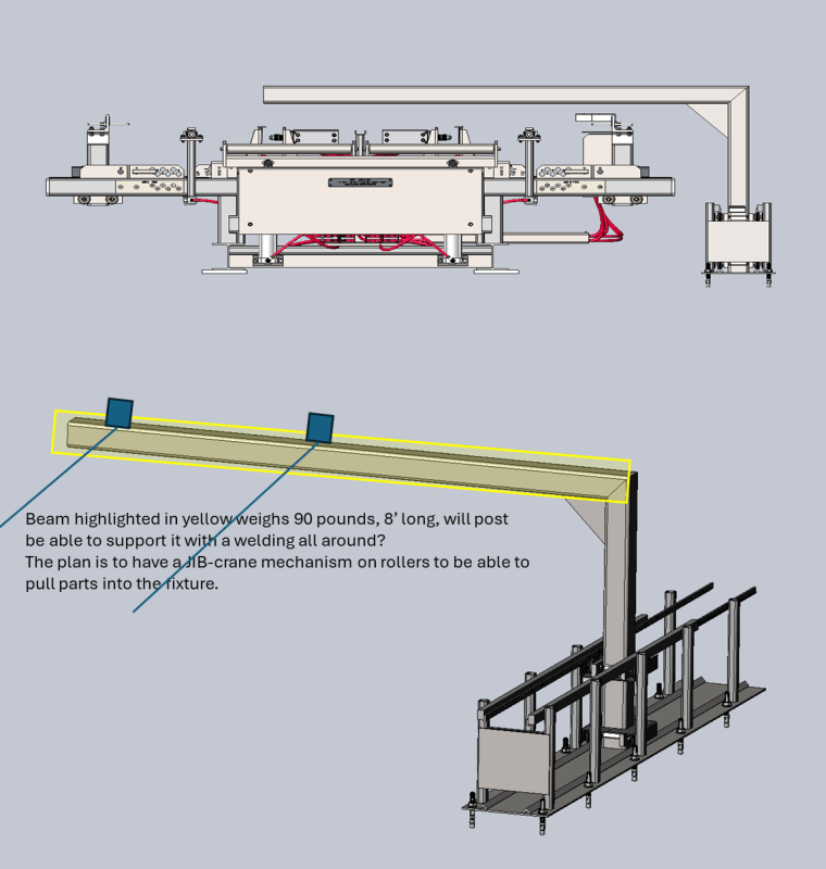

What do you guys think of this cart design?
Then having some kind of hook mechanism that can be attached to the working fixture, what type of mechanism you guys think I could use to start sliding the beams on top of the stack?
Any recommendations input on the design would be greatly appreciated!

Guess I missed the dimensions of the I-beam. Photo makes it look much bigger than your cart depicts. Or else that's a huge cart. LOL
The tag hanging on the end should have clued me in.

The cart could use some bracing and close off the tube ends.

I've twisted the idea and was thinking about having a jib-crane low rise mechanism which moves on a v-track guide using wheels, my question is, will the beam be able to support a 70 lbf pull? (That's what the average pull force measurement of the parts will be).
Also, what type of mechanism on a wire rope can I use to attach it to the edges of the beams using a plate clamp? Any ideas suggestions?

At the boatyard, we have a 1/2 ton chainfall on a trolley and a chain that has a ring in the middle and a hook on each end to pick and move the steel. Once you pick it, it's not hard to move with the trolley. I expect with a crane that has a rotating beam you could use a chainfall or hoist on a trolley and put the center of the beam anywhere within the sweep of the crane.
One thing to keep in mind is that once the CG of the beam slides off the stack, the unsupported end will drop and the end on the stack will rotate up.
