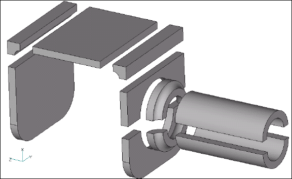

I have some questions concerning HEX mesh. My idea is to mesh a pin with HEX elements. I divided the fairly simple geometry into three cylinders, so it can be easily HEX meshed (without using the HEXMesh Bodies feature of FEMAP). I'll leave an image of the geometry below.
The problem is that the central cylinder cannot be meshed (I think it is because a circle line in the outer surface so it has a coincident mesh with the two outer cylinders). Actually, it turns red and FEMAP says it cannot be HEX meshed but nonetheless it gives a really nice mesh with which I can run an analysis.

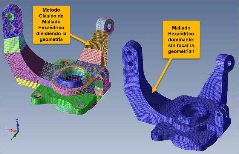

The difference between HEX MESH BODIES and the classical HEX mesh command is clear: only regular solids can be meshed.
Femap can only hex mesh “extrudable” solids, therefore if you have a part that is more complex, you must break/slice it into multiple, simpler solids that can be meshed. While we use the word “extrudable” here, the actual solids that Femap can mesh are much more complex than simple, straight extrusions.

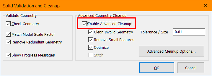

Before applying any mesh sizing run command GEOMETRY > SOLID > CLEANUP of the base solids to make sure the geometry is correct, enabling the advanced cleanup to remove small artifacts or invalid geometry.

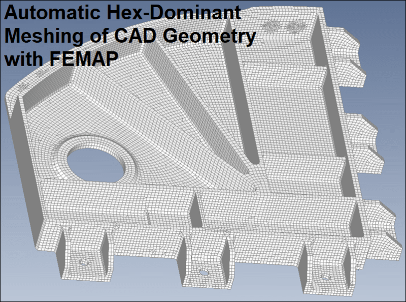

This is the modern command where you can mesh with HEX DOMINANT any solid geometry, not geometry preparation is required but the mesher will use TRANSITION elements like TET, PYRAMID & WEDGEs, but in low number. Is simply doing a clik in the solid body and done!!

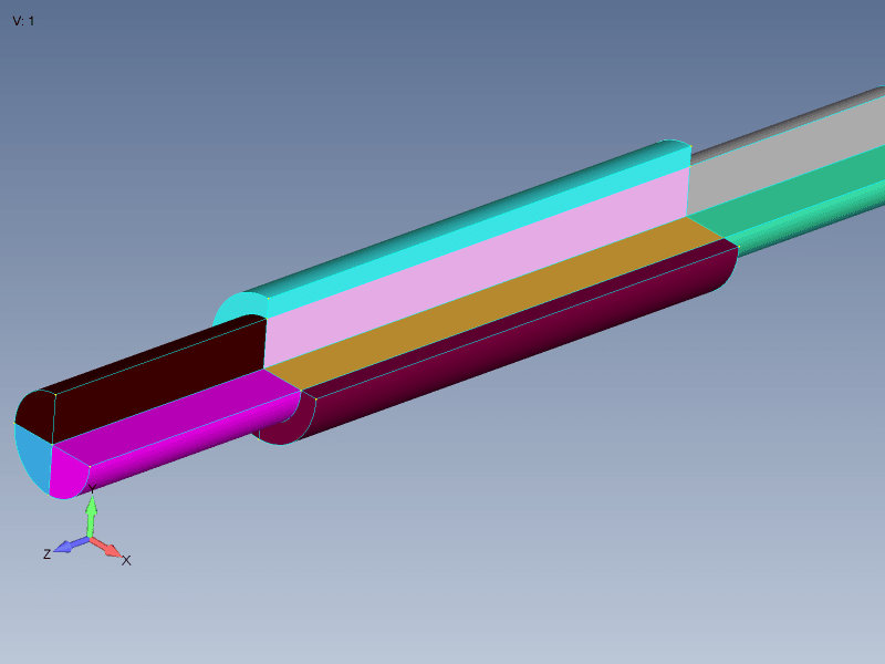

Your geometry look fairly simple. You need to make a couple additional slices to decompose geometry into simple parts. Use Solid Slice->Using Curve to slice middle cylinder into two collinear cylinders.
Here is my proposal how to divide it into hex meshable parts. 1/4 part of shaft is hidden for clarity. Different solids have different colors.

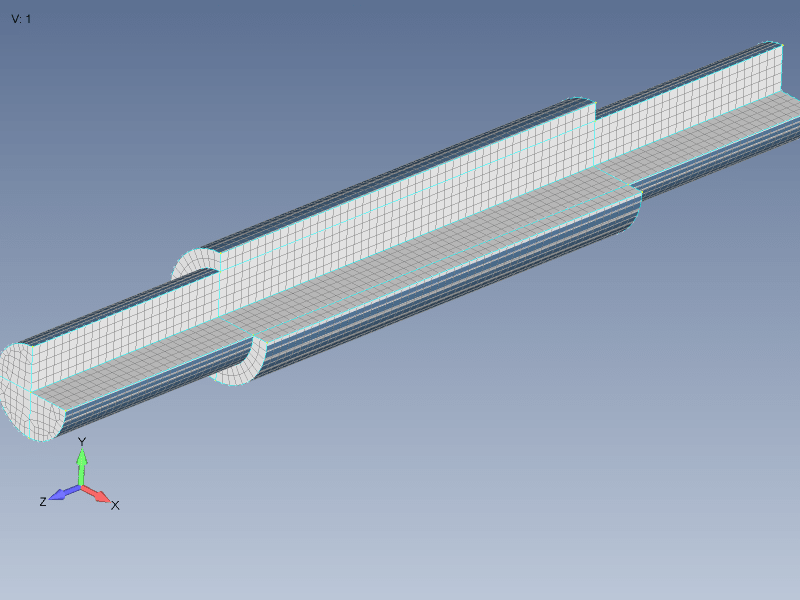

Now I can set mesh size using Mesh->Mesh Control->Size on Solid and than mesh using Mesh->Geometry->HexMesh Solids.
Now as solids are properly hexmeshed there are no solids highlighted in red.
