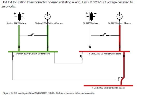

CS Energy has released its technical report into the 2021 C4 424MW steam powered generator failure of May 2021. At least one other independent report is expected to follow. The report is available at and includes a 20min video and a PDF.
There was a cascade of failures, but the triggering event was the collapse of the 220Vdc bus voltage at Unit C4 after the disconnection of two paralleled battery chargers. The well presented video explains that rather than sharing load, two chargers operating in parallel during commissioning, did not share load, but effectively loaded the one with a slightly higher voltage. When the two chargers were disconnected, the DC voltage from the new charger supplying the C4 unit collapsed. Pages 7 to 9 of the report list the sequence of events and include a voltage graph.
The report summary of contributing factors listed (my order):
1. A DC interlocking design that disallowed two independent batteries to be paralleled, thereby requiring chargers to be paralleled for DC redundancy
2. Battery charger/s that failed to share load when in parallel in a manner that allowed them to continue operation when separated
3. Unintended operation of "arc flap" (sic - arc flash?) protection that tripped AC to the generator auxiliary systems as a result of the DC failure
4. Failure of the DC automatic changeover switch which had been damaged 4 months earlier and presumably not been repaired
The combined AC and DC failure led to loss of lubrication oil to turbine and generator bearings and sealing oil which normally prevents hydrogen coolant from escaping. The hydrogen is believed to have combusted, the bearings failed and the generator ended up motoring at 300MW/1400Mvar until it flew apart. The Callide operators had dark SCADA system screens and were unable to determine exactly what was happening in real time.
I can't help wondering:
1. whether the 220Vdc battery chargers were designed unable to share load in parallel (which seems unusual) or whether one had a fault and
2. whether Powerlink, the transmission network operator did not see the power reversal and extraordinary reactive power flows which could have alerted them to the critical event unfolding.

I was going to make a comment about operating with a failed DC Transfer switch interlock controller long enough that that became a normal condition, however the report states something different.
Efforts to replace the failed part with a new design were in progress, but took too long as the event occurred before the new design was installed.
CS Energy does acknowledge revising a number of business processes as a result of this event, so perhaps they followed the string far enough to fix some of them.
The ability of battery chargers to share load depends on the same sort of decisions that allow paralleled generators to share or not share load. The report indicates that it was decided to change to a battery charger that is designed to share load better. Likely something like adjusting the droop curve. If the droop is too flat load will never share. If it is too steep voltage regulation will be poor, but load will share.
I have found the modern electronic style (switch mode) battery chargers to be incredibly unreliable. Mag-Amp only on my boats. I wonder which type of chargers were in use? I have a preferred brand, they may be the only one.

The switching (that caused the complete loss of critical DC supply) was carried out with C4 in service. Who decided it was safe to do so?
There where known faults within the 220VDC switchboards.
Who prepared this very expensive switching? (Two operators and their supervisor?) did they have access to knowledge of past failures?
Did the operator doing the switching understand what he was doing? (was he qualified to carry out such a critical switching)did his supervisor know how critical the 220VDC supply was?
Did the Power Plant Operater (PPO) of C4 know that the switching was about to be carried out?
(A switching that could cause a complete loss of control of C4).

Purely from knowledge based on that CSenergy video I would conjecture:
1. The C3 just didn't hit the unlike 'sweet spot' of DC voltage that triggered the cascade. Maybe C3 took the load and STATION lowered voltage. Or mabe the change over was 20s shorter and the voltage recovered without anybody noticing the issue.
2. The ACS on C3 was working whereas on C4 it was not. (This is probably unlikely as, in my limited understanding, had the sequence reached this point it wouldn't have been a smooth change over and lessons would have been learnt.)

4/ A industry standard Castell interlock System had not been fitted to the unit breaker to stop the isolation of the 220 VDC control supply when the C4 unit was in service.
5/ The original forensic enquiry by a structure engineer is on going
Indeed, the modification of the Callide C4 design, which included the removal of the Castell key interlocks, unfortunately led to a catastrophic failure. The attempt to improve the system’s redundancy and reliability inadvertently resulted in the complete destruction of the steam turbine, incurring significant costs.

To remove the critical Castell key interlocking is ignorance
(When an isolation, reconfiguration or load transfer has the potential to impact the 220VDC and 48VDC protection systems for Generator, Turbine, XY protection, GCB protection, AVR excitation and 275KV systems a Switching Sheet is required. When the configuration of the switchboard does not allow for redundancy to maintain the bus load during the switching process, no switching will proceed unless the unit is brought offline (desynched). All switching on these systems must have Site GM approval through the Operational Risk Assessment process (ORA).) is Callide’s way of not wanting to re-install the original Castell key into locking system.
So the Site GM has replaced the Castell Key locking system! because they are trying to hide their ignorance
What happened with C S Energy's Callide C4 was ignorance,the critical Callide C4 unit 220VDC Busbar was disconected from both the 220VDC batteries that were available with Callide C4 connected to the grid. No Site GM approval through the Operational Risk Assessment process,No written High Voltage Apparatus Isolation Instruction or switching sheet which had been replaced with a computerized black padlock proceedure, a complex series of events that could not have been anticipated, with some of the contributing factors being traced back to the original design of the power station," Mr Busine said. Most power stations use Castell keyed interlocks which would have been included in the original design to ensure that the critical 220Vdc backup batteries are always available when required.
Ignorance is just a lack of knowledge which can be lost by employees being retired, or Engineers changing procedures that have been developed over many years by experienced operators, coloured padlocks and computorized Isolation Instructions, the crazy operator training were every power company and every state does their own thing is a problem.
