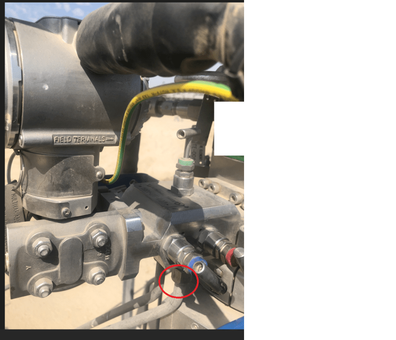

Hello,
I have a question regarding the 5 way manifold.
In my application, a multivariable transmitter will be installed on the 5-way manifold mounted into a flow meter.
Liquid samples will be taken from the 5-way manifold drain point regularly. I would like to know if there will be a risk that the multivariable transmitter could be damaged due to process fluid going into the multivariable transmitter while collecting samples through the drain port.
I have concerns about the possibility to have over the time some liquid on the diaphragm of the transmitter

Indeed it is a multiphase flow meter application. The MVT is a pressure, differential pressure transmitter mounted on a 5 way manifold as shown in the picture attached.
Samples are collected from the liner circled in red from the drain of the 5 way manifold.
This is NOT a multiphase meter.
It is simply a single transmitter which measures differential pressure ( presumably across some sort of orifice plate somewhere, pressure and temperature. See the brochure below.
You then tell it what the fluid is and it gives you mass flow and volume flow. With a multi phase fluid, none of the parameters are known to any degree of accuracy. So it will give you some idea of flow rates, but multiphase is notoriously difficult to measure.
A P&ID of this mysterious thing would be nice.
Taking a sample won't do any harm to your device, but if the flow is small then it won't be metered, but samples are usually small compared to flow.

Probably depends on the position of the sensors in relation to the drain point.
They should be located on the top of pipe, drains on bottom.
Mid level, who knows?
Give us an assembly drawing and PID.
Just to clarify the multivariable transmitter on the 5 way manifold which measures the DP and Pressure is mounted on a multiphase flow meter which has additional components such as venturi and radioactive source.
