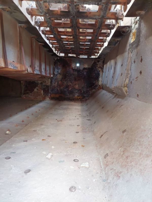

Could you possibly inform me about using Ceramic Fiber Blanket 1" THK in two layers instead of Ceramic Fiber Boards 11/2" THK for a partial replacement of the internal lining of a furnace (MWP: 1000 psi, MWT: 194 Fahrenheit, Burner using Fuel Gas) due to unavailability of insulation boards in our stock at the moment?
See photo for the existing internal insulation panels.
Thanks and best regards,
The issue is how will you secure the blanket?
And why has the board failed?
