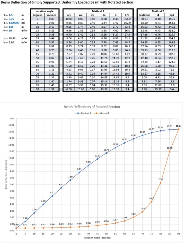

I'll follow-up with a spreadsheet showing the large difference in values between the 2 methods.

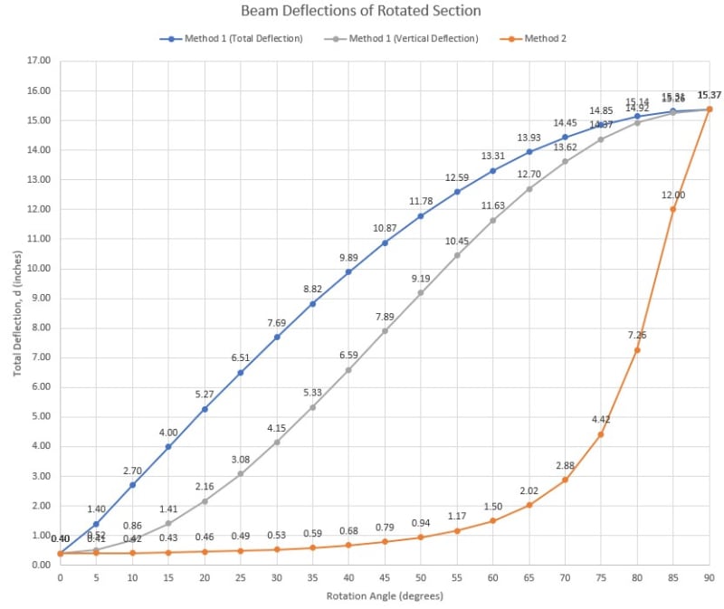

For a 2x10, simply supported, wood beam with a span of 144 in, a uniform load of 10 lbs/in, and an E of 1.4x10^6 psi, the following shows the calculated total deflection at various section rotations using both Method 1 and Method 2.
A few observations:
[ol 1]
[li]For rotations of 0 and 90 degrees, the results are the same for both methods.[/li]
[li]At a rotation of 45 degrees, the total deflection is 10.87" for Method 1 and 0.79" for Method 2![/li]
[li]At only a small rotation of 5 degrees, Method 1 gives a deflection nearly 1" greater than Method 2. Intuitively, this seems incorrect. [/li]
[/ol]
I initially based my analysis on Method 2, but in checking my results against Woodworks software, I was rather shocked. After some digging, it turns out that they use Method 1. I was hoping to come across some literature discussing this, but found nothing. If anybody is aware of anything or has insights into this, I'd be much appreciative! If all else fails, I might have to construct a model to test.

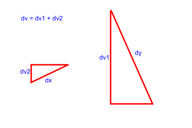

If you want the total vertical deflection, I believe equation 1C to be in error.
You need to combine the vertical component of each dy and dx.
the resultant you have calculated could be at an angle to the vertical
CDLD, You're right, but I was looking at the total deflection, not total vertical deflection. I may have mis-stated that above.

CLDL, Both are calculating total deflection in any direction, so it should be an apples to apples comparison. But you have a good point seeing that we're typically most concerned with vertical deflection. See the attached updated spreadsheet which also includes vertical deflection for Method 1.

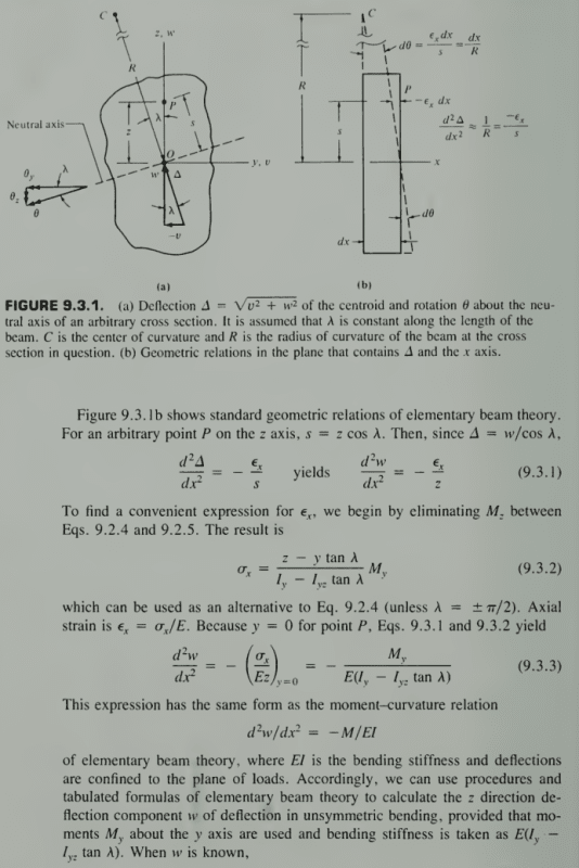

Method 2 turns into an unsymmetric bending problem and the normal d2y/dx2 = M/EI relationship no longer holds, see excerpt from Advanced Mechanics of Materials by Cook:
Your Method 1 resolves the loading to be parallel to the principal axis of the rectangular cross-section which restores the d2y/dx2 = M/EI relationship in each principal direction, so you can do the vector addition to determine the total deflection.
