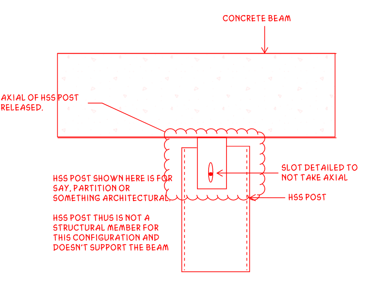

Feb 8, 2024 #1 Ramajhh Student Joined Feb 8, 2024 Messages 5 Location SY hello everyone i just want to know when we use shear release or axial release in Etabs program? what is the conditions? can anyone help please?

Feb 8, 2024 #2 Luceid Structural Joined Feb 16, 2023 Messages 253 Location US When you detail the connection to not take shear Upvote 0 Downvote

Feb 9, 2024 #4 BulbTheBuilder Structural Joined Aug 18, 2021 Messages 339 Location US How do you understand it? Try telling us how you understand it so we can help you implement it properly in your ETABS model. For now, see attached. Same applies to shear, moment, torsion, and all other forces. Upvote 0 Downvote

Feb 10, 2024 Thread starter #5 Ramajhh Student Joined Feb 8, 2024 Messages 5 Location SY okay now its more clear for me because i was just thinking about concrete elements so i couldn't understand the idea very well> thanks for explaining Upvote 0 Downvote

Feb 10, 2024 Thread starter #6 Ramajhh Student Joined Feb 8, 2024 Messages 5 Location SY i will be so grateful if you give me more conditions Upvote 0 Downvote
Feb 10, 2024 #7 BulbTheBuilder Structural Joined Aug 18, 2021 Messages 339 Location US Releasing restraints can also in concrete elements as well. Think of a precast T-beam being connected to a cast-in-place column. The T-beam will be simply supported with no moment restraints, so you release all moments and make it pinned. Upvote 0 Downvote
