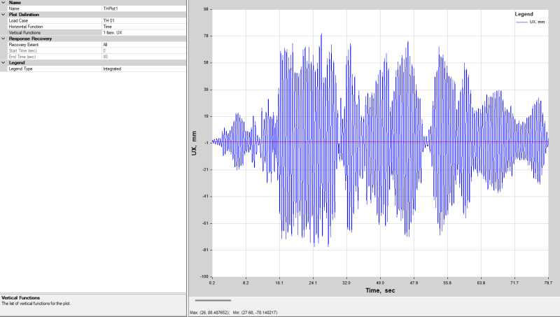

Hello everybody
I do not know how to use this function:
ret = SapModel.Results.JointDispl("ALL", GroupElm, NumberResults, Obj, Elm, LoadCase, StepType, StepNum, U1, U2, U3, R1, R2, R3)
Could somebody explain the use?

My goal is having the plotted function in a .txt file in order of achivieng a wrote the code.
Any suggestions of how can i achieve that?
I have uploaded an example to my github to retrieve time history displacements as well as the support .edb file.

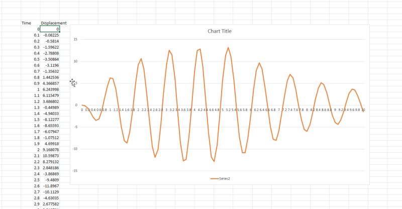

I access the results through the database tables. I did my data retrieval in Python, but plotted in excel. For some reason matplotlib was plotting oddly for me.
