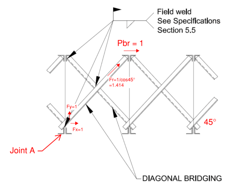

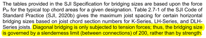

I'm not sure if it's just too late on a Friday, but I'm having difficulty understanding an approach by SJI (or maybe it's not limited to SJI)
I took the following snapshots from the SJI's Technical Digest #2. When they discuss diagonal cross bracing, they mention that it's designed for tension forces ONLY.
Putting together a FBD of the brace force, where Pbr is determined by Pr/joist depth... it looks like relying on the diagonals for tension only creates forces the adjacent brace into compression. Or else the joint is unbalanced. Take Joint A for instance.
Why am I not seeing it?
Furthermore, it says that horizontal bridging is design for compression only. Unless the sign is changing along the member length, I don't understand how it's compression only, when in reality joist displacement can cause (drag) on the adjacent horizontal brace.
Can someone help me understand this, please?
This is perhaps "tension only bracing" in the same sense as the old diagonal bracing, one neglects the compressive strength of the bridging. Now, as to your actual question, yet, it seems there's an imbalance. The joists generally deflect downward or upward equally, and my impression is diagonal bridging is most typically seen at the mid-span and is partly OSHA mandated for erection safety circa 1998.

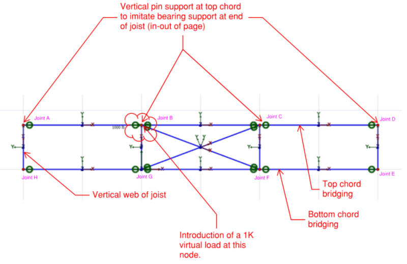

To get this conversation moving, I've provided a snapshot of my attempt at modeling this scenario. As expected, the model yields unbalanced reactions.
The Joints at A, B, C, D are supported in the Y-direction. While this may not be true at the location in the field, the joist supports the vertical loads (maybe it should be modeled as a spring). I'm trying to see how I can get the lateral load (introduced at Joint B as a 1K virtual load) to work it's way back into the share of vertical supports.
Is there a way to do this without having continuous top/bottom chord bridging down the entire line.
Another thought I had is: Does the horizontal top/bottom chord bridging and diagonal bridging create a faux 'perpendicular truss' to the span of the joists?

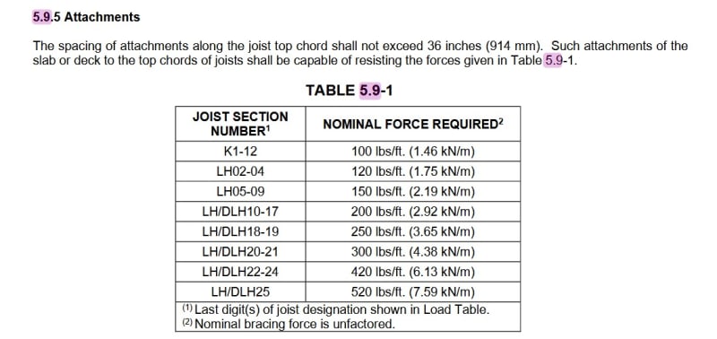

Other than this being a somewhat academic exercise I think you're getting a little bit lost in the weeds. Bridging (horizontal and diagonal) are focused on erection stability (keep the joists from rolling over when workers are up there) and has no intended effect on gravity loads/load sharing/diaphragm action as far as I'm aware. I've never considered bridging in any sort of joist analysis other than providing anchorage for the bridging. There's also uplift bridging but it's a bit different as lexpatrie noted. All of this is designed and provided by the joist supplier. The most we'd show on our drawings is just a visual representation of the bridging for new builds, and nothing for existing buildings.
Check section 5.5 of this doc (if you haven't already). [URL unfurl="true"]https://steeljoist.org/wp-content/uploads/2021/05/StandardSpecs_K_LH_DLH-Series_0820.pdf[/url]

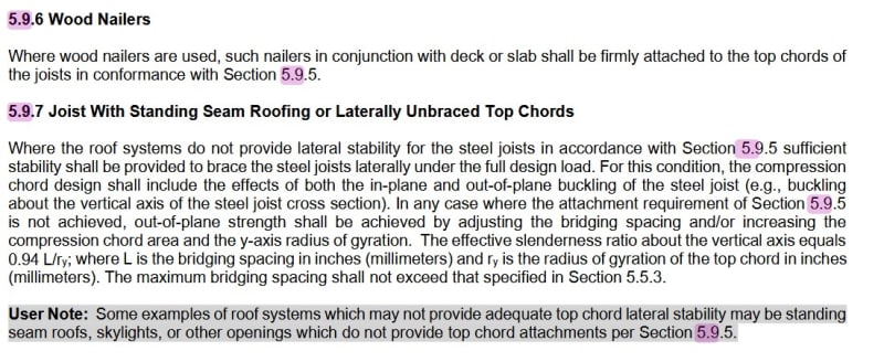

This may be of some use - Standard specification for K, LH, and DLH joists as of 2020.
If need be you can track it backwards through the 75 year catalog and tables to see what the requirements were around the time of original construction, if that can be reasonably established via the property assessor or satellite imagery.
I'll add the language about standing seam as well.
Incidentally, farther up in that section it has horizontal bridging at l/r of 300 and diagonal bridging at l/r of 200. The way the second item is worded, 5.5.2, the l is the full length of the bridging. The potential bolt in the middle of the "X" is not counted as a brace point or determination of slenderness.
I guess the point here is anything beyond the required strength and spacing for the bracing of the top chord (i.e. not the bridging, the metal deck connection) would potentially be available for restraint of "other" lateral loads.

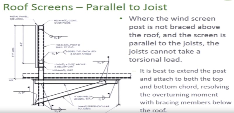

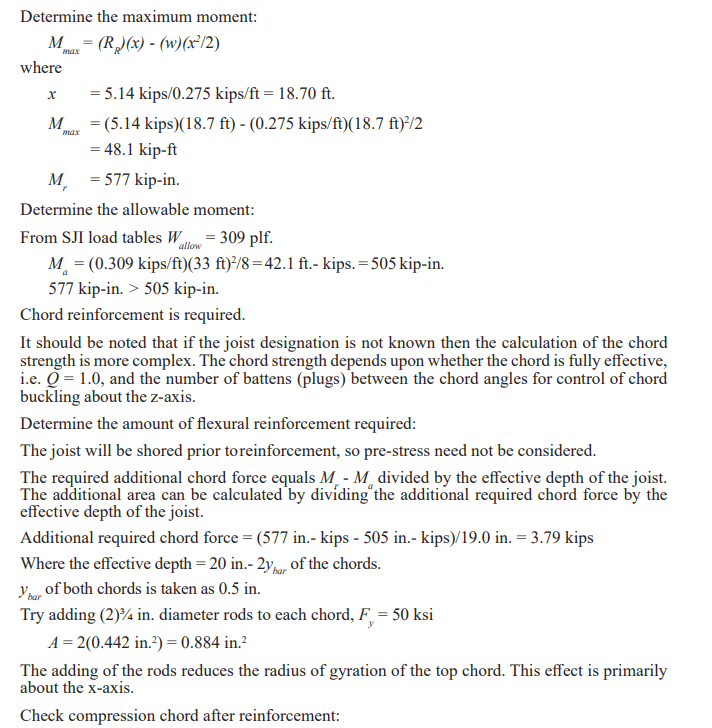

As to the original problem, lateral loads from RTUs and unit screens, look at Designing with open web steel joists, Fisher, there is some treatment of lateral loads across the joist from a guy wire anchorage. I thought the second edition had some designs for RTU screen attachments as well.
lexpatrie,
The Vulcraft reference (Designing with Vulcraft Steel Joists...) you mentioned was so helpful and has pointed me in the direction of another Technical Digest that might be worth purchasing. I actually have a hardcopy of it but didn't realize there was a special topic on joist reinforcing.

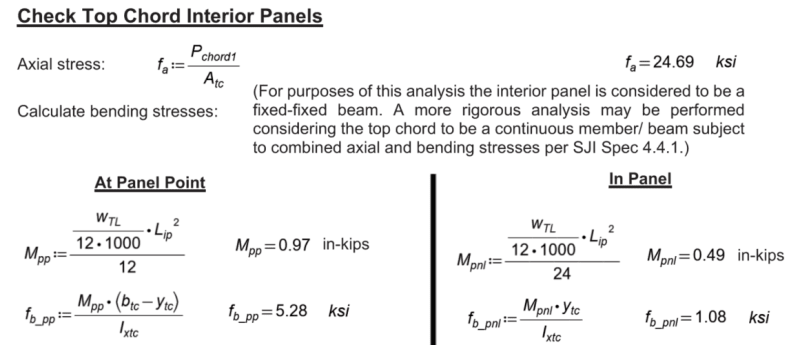

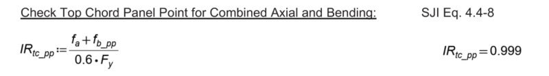

What's interesting is the comparison between Vulcraft's method of analyzing the joist vs SJI Technical Digest #2. One primary difference I noted was:
SJI Method
•When SJI checks the capacity of the chords, they first check the fa/Fa unity of the chord where fa = Pchord/A (where Pchord is determined from the applied moment divided by the joist chord moment arm)
•Next, they will determine the fb = Mc/I in the top chord interior panels (see snapshot below), then combined fa and fb is then checked via unity equation (fa+fb)/0.6Fy
Vulcraft's Joist Reinforcing Method
•For handling the moment capacity of the joist, only the fa/Fa ratio is considered. They don't actually add any contributing bending stress in the top chord itself.
Correct me if I'm wrong, but I find this analogous to:
•SJI is applying P/A +M/S, where the contributing bending stress is due to the fact that the chords are considered continuous through their span?
•Vulcraft is treating the joist as a truss with pinned nodes, and thus ignoring the stress contributed from bending. Here the M/S is eliminated from the analysis and we're only looking at the axial force in the chord itself.
Correction to what I was saying:
•SJI is applying P/A +M/S, where the contributing bending stress is due distributed loading applied to the top chord between panel points.
•Vulcraft is ignoring the stress contributed from bending of the top chord between the panel points. Here the M/S is eliminated from the analysis and we're only looking at the axial force in the chord itself.
Granted the fb stress is much less than fa, I'm not sure why Vulcraft is taking that approach.

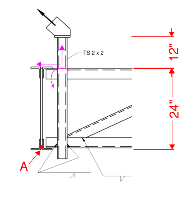

From the 2nd edition, pg. 83, how do you resolve this load path? If the joist depth is 24", spacing 60", and the load is 1K (45° at 12" above top of joist), what forces would you get in your framing members and how do we get resolve this to the overall building structure?
The y-component would put uplift in the joist on the left (let's call it Joist A). However, there is an eccentricity to this load since the horizontal angles are only attached to one side of the flange.
The x-component looks like it would be dragged out through the roof sheathing, assuming we have an adequate diaphragm here. However, it we didn't then what's the path (I'm assuming the top horizontal bracing would need to go all the way to the outside wall)? There is also a rotational moment to be resolved.
I'm trying to determine how to handle this load path via a simple FBD.
If we try cutting this and solving via method of sections (moment at A), we have (4) unknowns:
•Fx top horizontal brace/or dist. into roof diaphragm
•Fx bottom horizontal brace
•Fr diagonal brace
•Fy vertical component that goes into the joist.

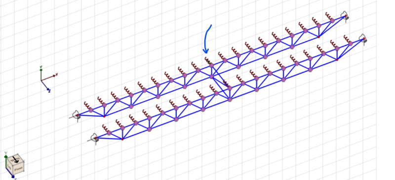

In an attempt to better understand this (emphasis on the attempt part), I created a basic model with the introduction of a 1K Vertical point load and 1K lateral point load at the node indicated with the blue arrow.
In order to keep my model happy and have no lateral reaction at the end of each joist (Z-direction reaction at joist seats), I had to create some soft of lateral support along the top chord of each joist. A spring support was placed at each node, which represents the presence of a metal deck diaphragm.
The first joist (the one that takes the initial later load) takes 500lb of force from the combined reactions in each spring. The remaining 500lb travels through the horizonal brace and the distributes into the springs that supports the second joist. The diagonal and bottom horizontal are zero force members in this situation.
Is this to say, that all lateral forces will directly distribute to the diaphragm and there is actually no need to create a triangulated brace at the introduction of individual point loads?
Keep in mind this was only a 1K point load. At what point do I have to worry about locally tearing the diaphragm?

As to your force question, why not disconnect the top chords at the angle brace frame to force the loads elsewhere? Remove the springs just at those nodes. If the diaphragm can't take that load, the analysis will show you where it goes, (intuitively I'm expecting a download and an upward load on the joists).
