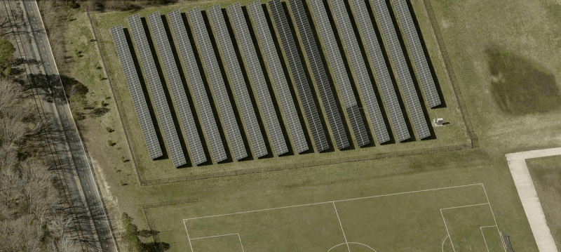

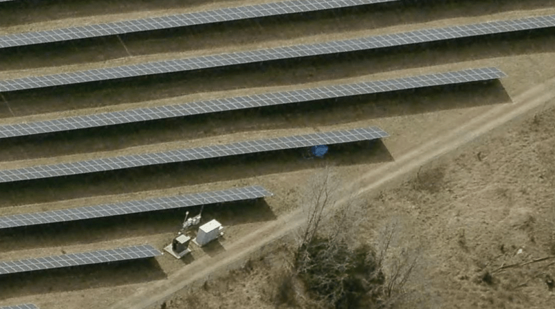

Land cover between panels will certainly vary from site to site. However, it is not necessarily going to be bare or eroding.
Here are a couple of sites in Delaware (flat) that appear to have decent vegetative cover.
