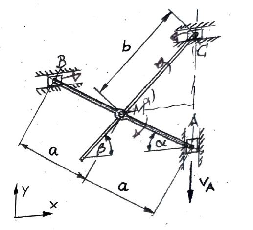

I don´t get how to determine the vector r(AB). I know that i have to transmit the given angels. Please help me guys.
The Solution is r(AB) = (-√3*a,a,0)
Task:
A rod 1 becomes vertical at its end A and at its
End B guided horizontally. In the middle M is a second one
Rod 2 is rotatably mounted, the end C of which is also horizontal
to be led. Point A moves at the constant speed
especially downwards.
a) Determine the velocities of points B and
C
​Given: a, b, α =30°, β =45°, VA=const.

Have you "scribbled" an alpha near the upper right corner of M ? I don't think that is right. I think that angle is beta, and the angle between Ab and the horizontal is alpha.
From geometry, cos(beta) = (a*cos(alpha))/b = a/b*cos(alpha)
But I'm not sure what "r(AB)" means as a vector ? it isn't AB (the rod, AB). if it is the rotation of the rod AB ... then describing this as a vector is, to my way of thinking, "odd".
Your second pic, has beta incorrectly placed. This angle needs to be (90-alpha).
I'm not sure the the track B moves in is perpendicular to track A (which seems to be vertical). No, your problem statement has B moving horizontally, and A vertically.
I would look at the triangle AMC, one side length a, another (the hypotenuse) b, leaving AC as ?, angle MAC (90-alpha), angle AMC is (alpha+beta), angle MCA is (90-beta).

The Solution is r(AB) = (-√3*a,a,0) What is r(AB)? Are you defining a 3D vector, i, j, k? Your sketch appears to be 2D.
Task:
A rod 1 becomes vertical (it can't become vertical unless b=a) at its end A and at its
End B guided horizontally. In the middle M is a second one (a second what?)
Rod 2 is rotatably mounted (does that mean the two rods are pinned at M?), the end C of which is also horizontal
especially downwards. (No it doesn't. The mechanism will bind.)
C (Are you claiming that point C is moving?)
Your verbal explanation of the problem is terrible and your sketches are even worse.

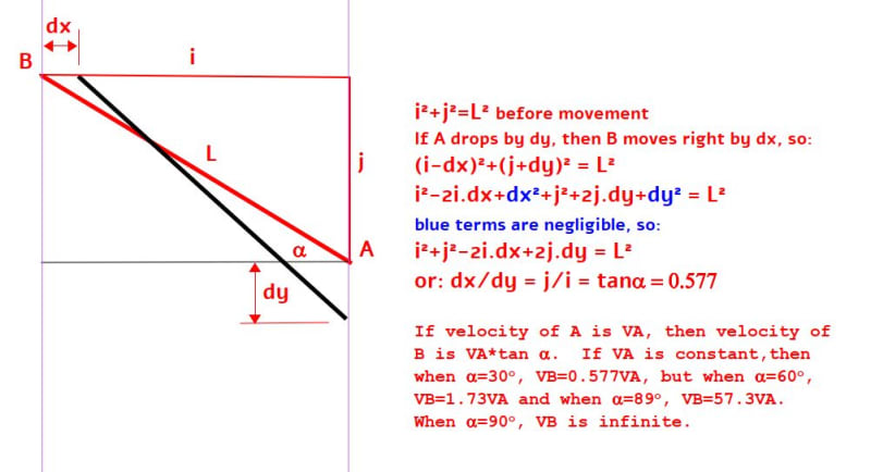

In a 2D system, vector AB = (i, j) where i and j are the X and Y components of the vector AB. So vector AB = (-2a.cos30, 2a.sin30) or (-√3*a,a)
I first thought the two rods were pinned together at point M, which would mean the mechanism would bind, but if Rod 2 passes through a ring attached to Rod 1 as it appears below, Rod 2 has no effect on the movement of Rod 1.
If A drops dy and B moves right dx, we should be able to find the relative velocity of B in terms of A's velocity.

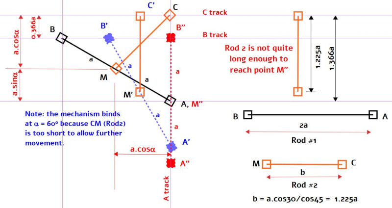

Rotations of AB (Rod#1) at 30, 60 and 90 degrees are shown in black, blue and red. CM (Rod #2) is shown in orange. I believe rb1957 was correct in assuming that the two rods are pin connected at M (not inserted through a ring as I supposed). If the angle beta is 45o, length of CM = b is not quite long enough to reach point M in the 90 degree position, which means that the initial angle should be modified.
So far as I can see, my earlier calculation of VB seems correct, but it somehow doesn't seem right that point B would be moving so fast at the end of the trip. I no longer believe that VC is zero, but I have not completed that calculation pending a change in the angle beta.

Not a problem, but there is still a problem with the geometry. If the two rods are pinned at M, then Rod #1 (AB) can't continue past an angle of alpha = 60o. It is stopped in its tracks by Rod #2 (CM) which is too short to allow it to continue to the final position where alpha = 90o.
this is based on the assumption (quite warranted) that C is directly above A.
We are told "b is given" and then not given a value, so we calculate a value based on an interpretation of the sketch.
We "could" start from the vertical " position, and for different b values (since the position of C is determined only by b) see if we can backtrack to the problem position.
Unless I'm mistaken, BA has determined b based on the starting geometry and C being above A. Thus assumptions positioned the track that C runs in.
What I mean is if b was 1.366a, so that the final " position could be achieved, then the original position couldn't be (beta would not be 45deg).
If b = 1.366a and beta = 45 deg, then C would be higher, probably not above A and further from A, and the final " position would (probably) not be achievable.

It may be concluded that Rod #2, CM has no effect on the movement of Rod #1, AB unless it is too short, preventing point A from moving to its correct position.
If CM is longer than required, it just moves along C track, and AB is free to find its correct orientation.
The locus of point M can be found by taking the average X and Y co-ordinate of A and B for any angle alpha. Point M will have both X and Y co-ordinates, except when alpha is 90o.
