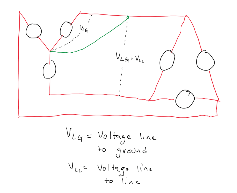

Thanks for the explanation; I just had to draw it out.

There is no ground reference in the diagram above. Did you mean to ground the star point of the source?
You need to find out if it is an ungrounded system. As davidbeach points out, most medium voltage utility systems in the US are solidly grounded. In this case, the voltage to ground is 7.6 kV. It doesn't matter how the transformer primary is connected. What matters is the voltage feeding the transformer.

1) The case Jaime presented was a Dyn distribution transformer getting supplied from the yn connected secondary of a step-down transformer. So, star neutral is grounded at the sending end of the line.
2) In the case you mentioned, there is a delta connection on transformers at both ends of the line with grounding transformers at both ends. I have seen such a system in Syria. Then without grounding transformers the type of phenomenon ( termed Neutral Inversion) that you
described can happen. This neutral inversion will disappear if (a) you have high capacitors connected to the line, e.g. Surge absorbers connected to tertiary of EHV auto-transformers, or (b) an electromagnetic PT (star-connected primary winding with neutral grounded) is connected to the line.
