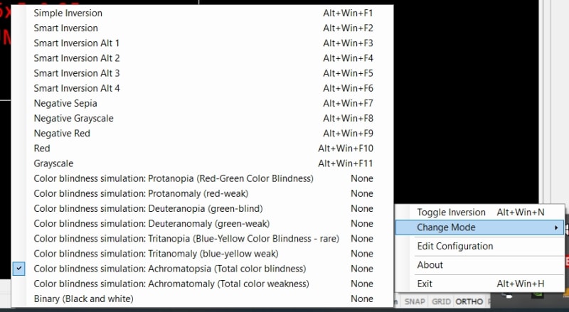

Does this help?
with the selection 'Latest binary version (if you don’t know what to download, take this one)' If you can expand it in a 'Sandbox' and try it. It seems to work OK. I've attached a snapshot of the configuration file:
