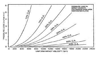

I'm trying to calculate the flow of air into a furnace. The flow of air goes through a grate that comes from a large duct and discharges into the furnace through very small holes. I know the size of the grate holes, and the air pressures on the upstream and downstream sides of the hole, and I know the air density (incoming). The incoming duct is large enough (>1000 times the size of one grate hole) that I can assume incoming velocity to be about zero. I don't have any other information.
I've been trying to apply Bernoulli's equation on this for about a day and I can't see how to find velocity without know the pressure of the air going through the hole.
Does anyone have a way to do this? I'm glad to write a program to solve it iteratively but I can't figure out what equation to use.

See page 6-19 and 6-20 in Perry Chem Eng Handbook, 7th edn for approx flow estimates for air flow across screens with square mesh holes.
Thank you. But I don't have that.
What is it about the Perforator's Handbook graphical method that you don't like? This is going to get you in the ball park. You may just need to perform some field testing if you want "exact" flowrates.
If you know the %open area (which you can easily determine from hole diameter and spacing, see p.49) and pressure drop you can get a velocity, which can be corrected for density variation.

I forgot to mention that trying the calculate the flow through holes in a grate is difficult, even a precisely machined orifice has a discharge coefficient, trying to calculate from holes in a grate would take a lot of accurate testing.
Best to work from the source of the airflow because what goes in must be the flow through the system.

I apologize for not being clearer. I wasn't trying to solve the problem of air flow, I was trying to figure out if I could calculate air flow based on orifice size and differential pressure. I now know it's not possible to do this accurately. I wanted this information to do approximate checks of fuel to air ratio.
The best way to do this would be to put a pitot tube in the duct for the FD fan and then check air flow for several fuel rates.
