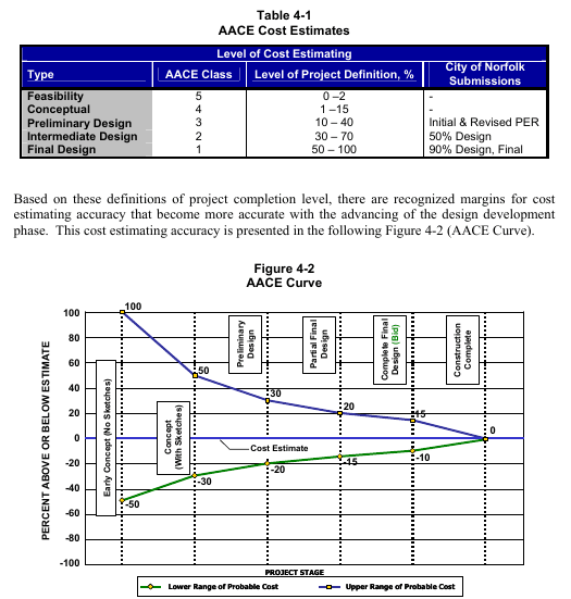

Often forgotten by management is that preliminary pricing before project definition has a very wide margin of uncertainty.
As the design progresses the cost estimate will change, and the uncertainty will be less.
The project budget must be adjusted toward the estimate before bid time.
Picture from Sewershed Investigation Guidance Manual - City of Norfolk, Virginia

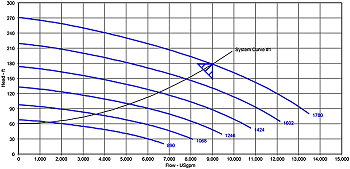

VFD control reduces flowrate AND available pump head - if you need a specific pressure and adjustment on the flowrate, there may be difficulties in attaining this with VFD.
