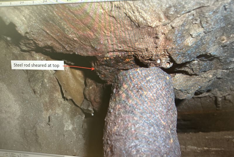

"Critical failure" closes I-195 west on Washington Bridge in Providence, Rhode Island - CBS
Casey Jones - Youtube has already done a review - Why does it take three days to close a bridge?
The failed anchor rod is part of the center span. I don't know which pier is involved. There is an east and west span so it will be interesting to learn if deterioration is similar on the alternate span.

I don’t have experience inspecting bridge superstructures, but it seems like the corrosion at the failure plane would take longer than a couple of months, but maybe I’m missing something.
That fracture looks too pristine for a shear fracture... but, I don't know what else could have caused it.
I've seen local news items that the "Mile Long Bridge" in Texas has been closed due to a boater seeing a piece fall off the bridge. But haven't seen any details of what the actual failure consists of yet...
Is the necking due to corrosion or is this a tensile failure?
The totally flat failure surfaces indicates a brittle fracture... corrosion is too bad to speculate more. With 'necking' you often introduce a triaxial state that would produce a different failure surface.
Something is odd about that failure.

Inadequate maintenance for a long time would do it, I guess. If you dig into the RIDOT public documents, those securing rods have wasted away significantly (down to something like two thirds of their original diameter). That didn't happen overnight, and is just one of many seriously degraded structural elements.
If they have let it go too far, it may be just more economical to demolish it. It also seems that they may be able to get an emergency handout from Uncle Sam if they declare it a total loss.
...and no responsibility for the inadequate design?[ponder]
Is the design inadequate? (I don't know.) Empirically, it seems to have been at least minimally adequate to have stood for many decades of steadily increasing traffic. Even if there are design elements which could have been better, it seems to me that the problem is primarily letting it deteriorate to the point where they now consider it to be dangerous.

I've been told that these tie-downs have been known to be an issue for years. Inspections performed by 3rd parties have noted this. The current rumor is that the DOT director has known this for that period of time and deferred the repairs due to concerns the repairs would have on traffic.... haha
Dik - 50 to 70-year service life of bridges is common around here for bridges built in that era. Now, they are shooting for 100 years for new construction. The real issue is deferred maintenance.
