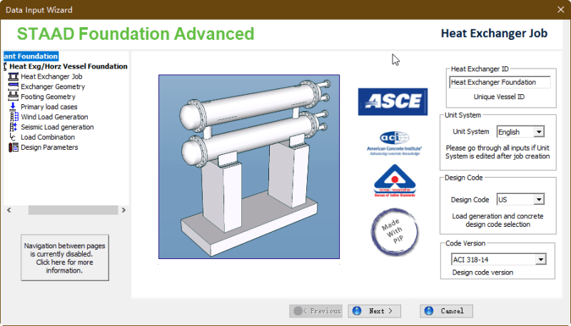

Is Double Pipe Exchanger and Stacked Exchanger the same concept?
tmgczb
May 12, 2021
176
CN
PIP specifies that Bundle load shall not be considered for fin exchangers(double pipe exchangers).
Stacked exchanger look like 2 big pipes.
So I have above quiry.
Occasionally an internet search comes up with something useful.

Is this double pipe heat exchanger or not? There are 2 pipes.
Christine74 said:
If I understand your question correctly the answer is no, thermally speaking a hairpin heat exchanger is not quite the same as a set of stacked shell & tube heat exchangers. The reason is that a hairpin exchanger typically has a 100% countercurrent flow arrangement, so it's the most efficient arrangement possible.
A set of stacked shell & tube exchangers typically doesn't not have purely countercurrent flow. For mechanical reasons, such exchangers typically have two or more tube-side passes but only one shell-side pass, so typically they're only maybe 90% as efficient as a hairpin arrangement.
-Christine
From your sketch you can see that there is an Inlet and an Outlet nozzle on each channel, so there's no way that those can be double-pipe heat exchangers. Those look like convention "stacked" shell and tube heat exchangers to me, possibly TEMA "BHM" fixed-tubesheet heat exchangers.
-Christine
Agree with Christine74: the diagram for the "STAAD Foundation Heat Exchanger Job" is two physically separate exchangers, each with their own inlet and outlet. The interior geometry of the individual exchangers is unknown (from the image)), but a reasonable assumption is that it is a conventional "stacked" shell-and-tube design.
