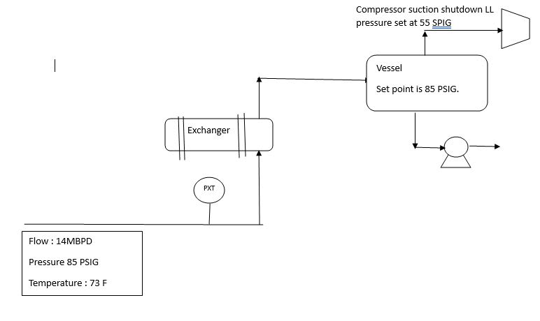

We have a Pressure Shutdown Transmitter installed in a pipe to shut on LL pressure scenario, the old trip set point was 105 PSIG, the pipe contains Condensate of about 14MBD, the flow is still the same but we have lower pressure in the system from 150 to almost 85, but now I need to lower the low low trip of the PXT. What would be the recommended Low Low trip and what are the criteria to choose the right new Low Low trip?

I forgot to mention that the LL trip is set for a tube rupture case to protect dowsntream exchanger shell side, but there is also a Pump installed right after the exchanger
So LL is set to shut the system down if the shell blows.
You probably have a wide range of pressure settings that would work. It should probably be above VP. Anything lower would only delay the eventual shutdown that is surely soon to follow. And gassing in the system is not likely desirable in any case anyway. You would probably want to shutdown at VP even if the shell did not rupture.

Can you put up the process diagram where this low pressure transmitter is located. In many cases, low pressure trips are an operating nuisance, and should be removed to avoid nuisance trips. Tube rupture will remain undetected for small HX leaks, so what is the point of this low low trip ?

the stabilizer Condensate Reid Vapor Pressure is usually around 10 psi, I have send the raw condensate to be analyzed by the lab. I don't have the raw condenste vpour pressure ath the moment.

The PXT at this location is a duplicate of that on the compressor suction, and in any case is not doing anything useful. It would be better to relocate this PXT to the shellside of the HX as penultimate instrumented high pressure trip prior to overpressure relief. This high pressure trip should cut off inflow to the HX tubeside. No need to trip the compressor or the pump in this case as both these machines should go into full recycle. Am assuming there is no PSHH on HX shellside at the moment.
Also check that this HX shellside overpressure relief setpoint also protects all other devices operating in parallel on the shellside (at other HXs' etc). What do you have on this HX shellside, and what other devices are also operating in parallel ? You may need to run a mini HAZOP of sorts to make sure all overpressure relief scenarios and low temp / freezing risks are addressed when there is a tube leak at this HX.
