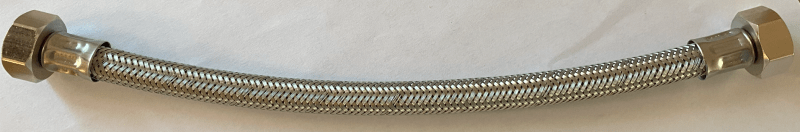

there are short flexible hoses up to G1/2" 50 cm long that connect various parts of the system. They are help in place with cable ties

Use the fittings used in recreational vehicles. Straight female swivels with internal rubber cone washers. They are used in your attached pump video.

- We are using G1/2" female swivel connectors (14 TPI). I have checked with the production manager and the torque that is being used is 15 Nm which is a lot lower that your post suggests we should be using. We are using a Facom R.306-25D torque wrench. Before we used the torque wrench, we had problems with under tightening and over tightening. Over tightening damaged the washer. I have not been able to find a torque charge online for G fittings. Would you know where i could find one?

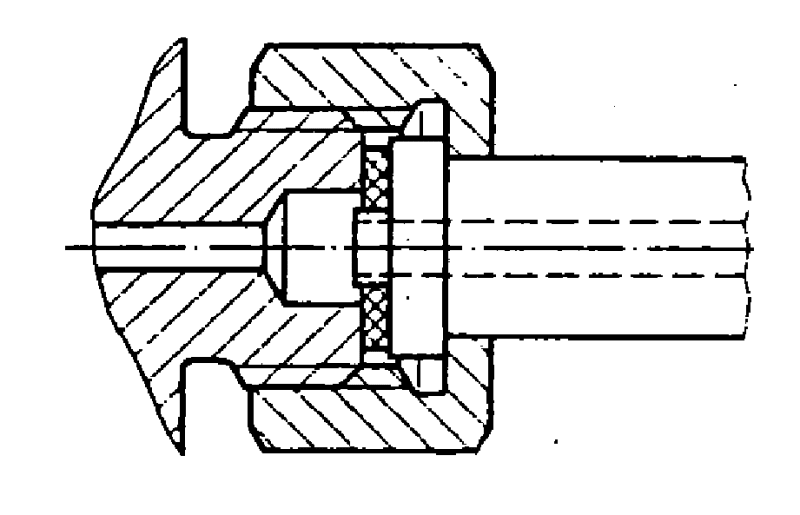

The image below shows a typical connection on a cylinder valve outlet; e.g. a pressure regulator connected to the valve of a gas cylinder.
For a similar configuration with G 1/2 threads and gasket as sealing method we use 60 Nm of torque to make a secure seal at 230 bar cylinder pressure. Note the nut is made of stress relived, surface treated CW614N/CZ121 (CuZn39Pb3) and the gasket material is PA 6. The pressure regulator experiences quite the shock load when the cylinder valve is first opened. For a repeated test of 1000 pressure shocks no leakage was detected and no retightening was required. Note that everything stated above also holds true if the seal is an O-ring or bullnose and cone seal (metal to metal). (For in-house applications we have abused our equipment with similar configurations for years - I estimate around 30000 cycles in the product lifetime - no leakage at the gasket as of yet)
Considering your systems low working pressure I would recommend trying 25 Nm and call it a day if the gasket shows no sign of damage (test it - repeatedly). If needed you can use Loctite 243 or another thread locker.
