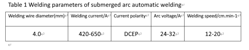

1. Selection of Submerged Arc Automatic Welding Materials
For submerged arc automatic welding, both the wire and flux directly participate in the metallurgical reactions during welding. Their chemical composition and physical properties affect the welding process, influencing the chemical composition, structure, and properties of the weld metal. Using suitable welding wire and flux can achieve moderate fusion of the base material, thereby improving the strength of the weld. The welding wire H10Mn2 has good compatibility with ZG20SiMn, with high alloy element content, effectively refining the grain structure and enhancing the weld's plasticity and toughness. The flux, selected to match the welding wire H10Mn2, is the sintered flux SJ101, which is lightweight, consumes less during welding, and does not significantly increase Si and Mn in the weld metal. It is metallurgically neutral, exhibiting excellent welding process performance, stable arc combustion, easy slag removal, aesthetically pleasing weld formation, and high low-temperature impact toughness. The flux should be baked at 300-350°C for 2 hours before use.

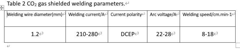

2. Selection of CO2 Gas Shielded Welding Materials
CO2 gas-shielded welding uses both solid wire and flux-cored wire for welding. The wire serves as both the filler metal and the conductive electrode. The chemical composition of the wire, in coordination with the shielding gas, affects the chemical composition of the weld metal, which in turn determines the chemical and mechanical properties of the weld. The flux-cored wire contains flux or a mixture of metal powders inside, promoting metallurgical reactions between the molten core material, base metal, and shielding gas during welding. It forms a thin layer of liquid slag covering the molten droplets and weld pool, protecting the molten metal. E501T-1 flux-cored wire is recommended for achieving optimal weld quality. The purity of the selected shielding gas (pure CO2) should be greater than 99.9%.
3. Selection of Welding Parameters

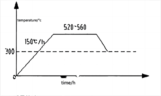

4. Preheating before welding, heat treatment after welding
The temperature of the welding area reaches 150-200°C and reaches this temperature throughout the welding process;
After welding is completed, the inside of the workpiece
A large amount of welding residual stress is generated. To prevent delayed cracks and deformation during processing, Shape and annealing treatment should be carried out promptly after welding.
The annealing temperature should be controlled at 520-560C. The heat treatment curve is shown in the figure.
