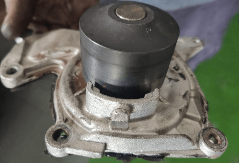

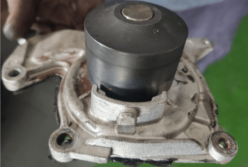

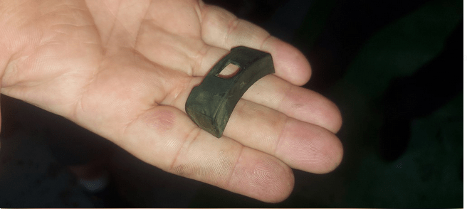

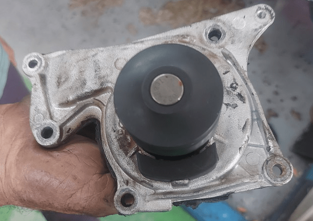

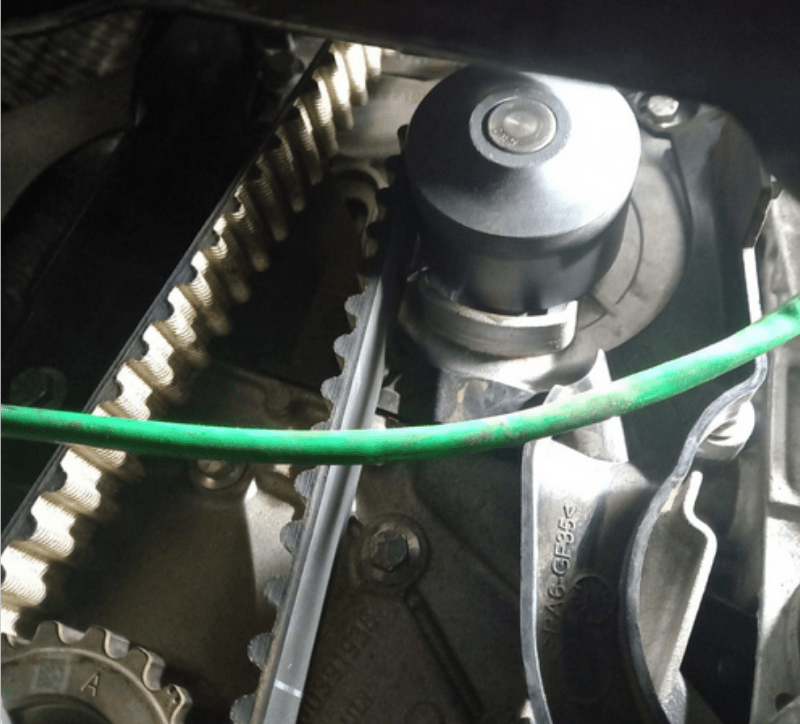

What is the purpose of the semicircular rubber and the metal piece where is inserted ? 1
Why don't people see the Camera and Image posting button?
I don't see a semi-circular rubber part.
What vehicle is this from and is there a photo of it when installed?
Water diverter in case of a seal leak?

Belt whip suppressor? Random guess.If so there will be wear marks on it.

NVH damper.

1. Belt whip suppresor ? Can you put images and uses ?
2. NVH damper. Can you put images an exact use in this case ?
3. Water diverter in case of a seal leak? . I don't understand. Can you put an image example to understand ?
Best regards
I think you're over thinking this.
It's clearly a protective device so that the metal upstand doesn't rub on the rubber belt and destroy it over time.
Maybe in a different vehicle it acts as a guide to stop the belt moving down.
Who knows? - the designer probably.
Many components are designed to fit multiple different engines or vehicles. It's not practical to remove something designed for one which isn't needed for a different engine.

But what protection exactly gives to the distribution belt. I don't see it.
I want to know.
Stops the belt contacting the metal upstand .
Also stops the belt from sliding too far down the pulley.

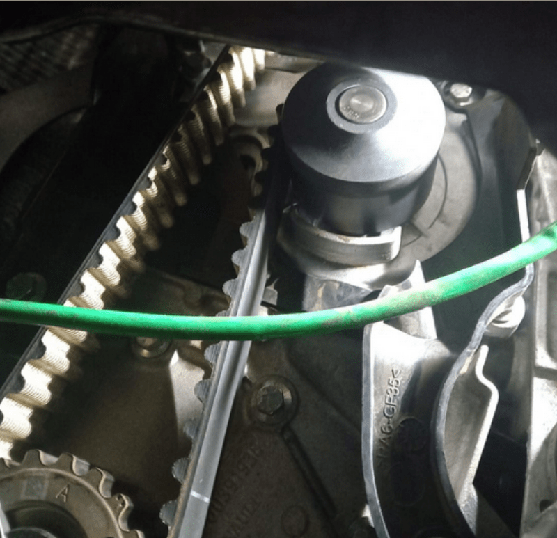

I am up to my eyeballs in Youtube recommendations now about this water pump and similar - this basic design is used by a number of car companies and some have a rubber piece, but most have only a plain curved metal portion. The belt is nowhere near the curved protrusion as it wraps around the other side, at least no closer than it is to every other surface on the engine. Probably it did serve some purpose and the design has just been copied over even though that purpose no longer exists.
Some very similar water pumps have an inlet opening under that area and an arc of metal carries over it to support a boss and bridge the load from the boss to keep the thin section from cracking, but that isn't the case here.
If the belt made contact with the rubber, it would rapidly abrade the rubber piece. If it was able to reach the metal the belt would then chew into that. A large area of rubber against a small piece of metal can do a lot of cutting.
Except for the fact this is driven by the timing belt and a lot of trouble to replace, I'd suggest the OP saw it off and see what happens.
There also appears to be other covers that go over the timing belt for the series of engines that use a similar water pump. I suspect they are different on different cars and that some cover comes into contact with that rubber part but not knowing what car this is from makes it a problem to be sure.
One I saw had two separate covers, one plastic and one cast metal, with the metal one going over the water pump, but the pump did not have either the rubber or the protrusion.
I am not able until the moment to folow your reasons about the rubber or the protusion.
What is exactly the purpose of that pieces really in an engine ? a diesel engine ?
Yotutube videos show me that these pieces are not necessary at the present moment....
Nobody has found any other example about this....

3DDave I don't see an image with the use of the rubber and the protusion.
yo seems to be sure that the problem is solved. But it's not.

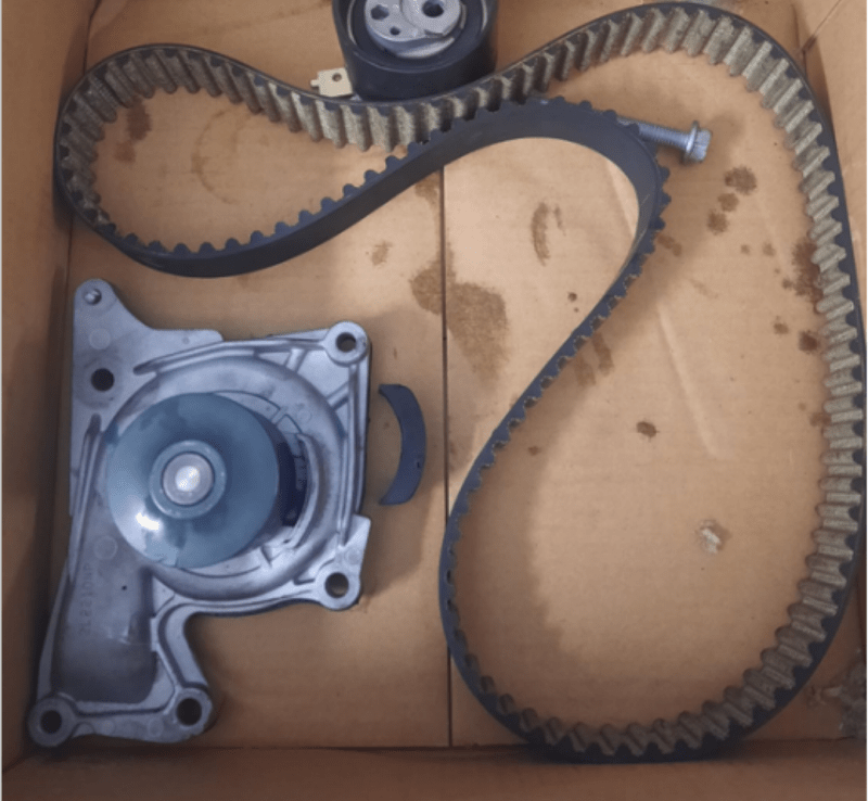

I have found a possible car : Dacia Logan . Perhaps you can help with images. Best Regards
You can't see it because it is under the cover that is supposed to be there.
