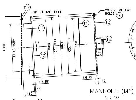

Hello, I am currently working on a case for re-rating of pressure vessel.
The vessel is currently designed for 6 kPa and needs to be re-rated for 20 kPa.
I am checking the manway flange design (its a non standard flange- ring type flange with plate used as blind cover).
I tried ASME Appendix 2 design, however its not passing in gasket seating condition, however there is no overstress in operating condition.
My question is, since this is an existing vessel, is it necessary to re-check the flange design for gasket seating condition?
I would appreciate if you have some idea about similar issue.

Hello everyone, thanks for your quick responses. really appreciate that. I am attaching the snapshot of the nozzle details for your refernece.
Few comments:
1) The vessel is indeed neither ASME U stamped nor PED compliant, as original design pressure was 6kPa. Hence the design is based on "sound engineering practice".
2) Gasket material is sigraflex HD.
3) I have compared the flange dimensions with API 650 manway flange and there are few differences, hence I cannot qualify this flange based on API 650.
4) The flange has raised face and a confined gasket which is creating problems in gasket seating conditions. Had it been a full face gasket, it would have easily passed the taylor forge calculations.
5) I was trying to qualify this flange so that no modification is required in the vessel (since the pressure increase is from 6 kPa to 20 kPa, my intention is to retain the existing vessel as far as possible)
6) I was trying to use app 2 to calculate and qualify the flange, as I do not know any other "sound engineering practice"to do so.
I have following options on my mind:
1) Replace the manway flange and cover with a new flange-cover pair having full face gasket and more no. of bolts.
2) Machine the raised face on both flange and cover to make it flat face flange and use full-face gasket.
3) Use the existing flange as is by hydrotesting/pneumatic testing the vessel at higher pressure (~20kpa)
any views on this?

Actual thickness of flanges and nozzle?
1) Try increasing allowable stress
2) Add stiffening bar 10 mm x 50 mm on the cover plate
Regards
Try this?
Try looking at TEMA flange design.
Asme VIII App 2 flange design is notoriously conservative and often fails b16.5 flanges
For the BCD you seem to have a low number of bolts.

Or use an ASME B 16.47 B type 26" class 75 flange? Thickness double (31.9mm), 36 bolts, but no one can fault you.
Overkill yes, but makes it easy.
Or do an API 650 manway.
usually a full face gasket results in lower surface pressure, but needs more bolts or a larger BCD.
What are the "taylor forge" calculations?
