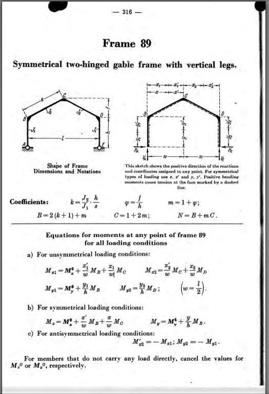

If you just want to check your program, you could use Kleinlogel Rigid Frame Formulas (see below).

Gre
I too am pleased that you were able to resolve the problem on your own Tygra, but for those who may believe that Kleinlogel Rigid Frame Formulas deal exclusively with vertical loads, please be aware that the tables deal with any type of load, including horizontal loads. There are several pages associated with Frame 89, which I did not post.
Prior to the computer age, structural engineers regarded Kleinlogel as the go-to reference for rigid frame design.
