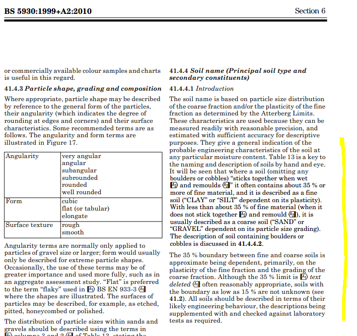

Dik in the UK we use 15% as when the material will perform like a cohesive material during compaction. anything above 15% fines is classed as a Class 2 fill, either dry or wet depending on its moisture content relative to OMC.
For engineering performance, i.e. will it have an undrained shear strength, will it consolidate, about 30-35% is more appropriate. Not this applies to run of the mill Clay minerals. If you get 15% of a highly sensitive, highly plastic Montmorillinite then the % of this material that makes the entire unit perform as a cohesive material will be lower. See extract below of BS5930 which is the British Standard for soil classification.
dik said:
Do you know of an approximate percent of clay that causes the matrix to behave like a clay. I've arbitrarily used 15%... is this a realistic number or should it be lower or higher?
I don't believe there is a minimum clay fraction (below 0.002) that determines the behaviour. This depends on the clay minerology, I just look at if the atterberg test plots above the A line. For example if you mix wyoming bentonite (a super plastic clay) with pure silt you won't need much to get clay behaviour.
