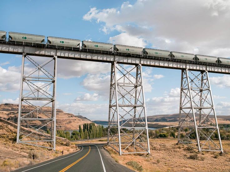

I sing the praises of the railroad bridge: the cheapest design that will do the job for at least 100 years. In particular, the generic through steel truss. And I especially like what is called the "steel trestle", as the strict geometry conforms to the land contours:
(and hardly ever falls down)
