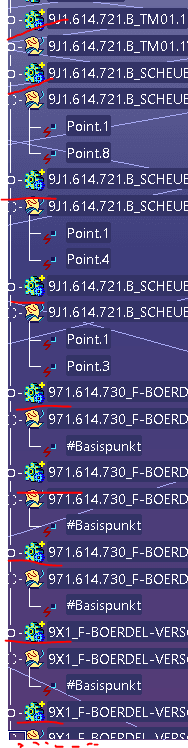

When I form an allcatpart, it leaves the same amount of tree products
