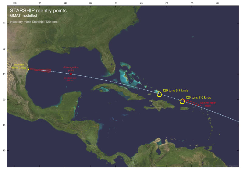

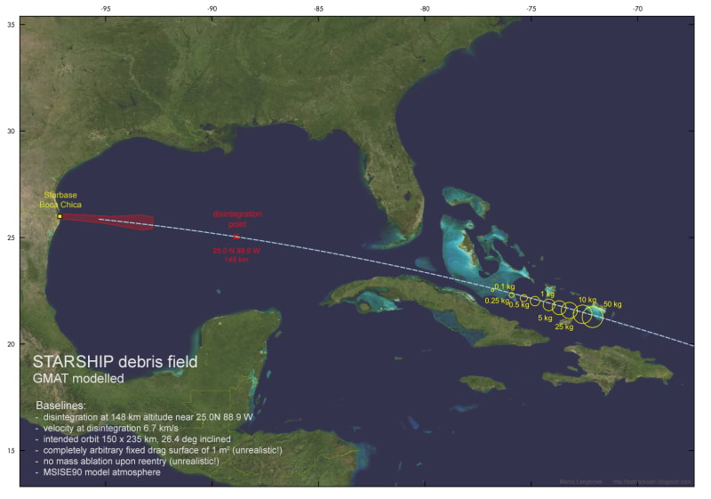

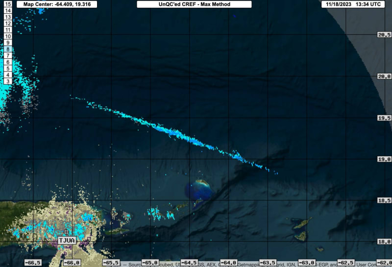

Launch track and disintegration debris pattern from the first stage... and the upper stage.. Flight #2. Hmmmm I wonder if the actual... farther-down-range... upper stage debris field(s) was also anticipated and built-into in the emergency planning.
Debris field model [predicted?]...
Apparent upper-stage debris field...
WX sat radar track of upper-stage debris...
I had presumed that the launch track would be thru the gap between south Cuba and Cancun MX. Boy-o-boy was I off base. The F#2 launch track 'threads' the gap between the Florida Keys and the Northern coasts of Cuba, Haiti, Dom-Rep and Puerto Rico. The debris from the F2 upper-stage appears to have ended-up in the sea just north of Puerto Rico. Hope there were no close-up/in-person witnesses land/sea/air.
