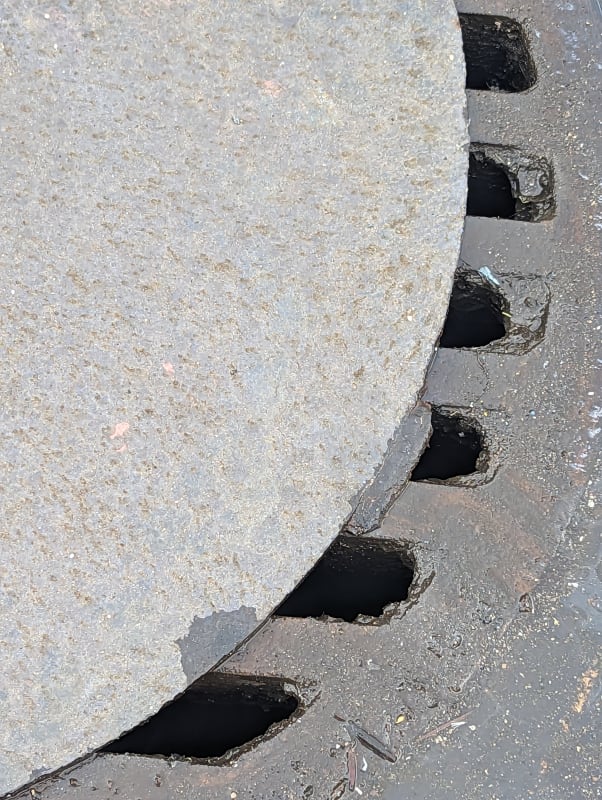

My understanding is that it wasn't the cover that came loose, but the whole top of the pipe/the concrete around it.
The picture shows beveling around the hole. Maybe they were planning to fill it with epoxy.
Looks like the street repair is to fill the hole with asphalt.
Newer report says it's a water valve cover, which make the most sense. Just imagine the joy the water company workers will have when that valve needs to be accessed.
