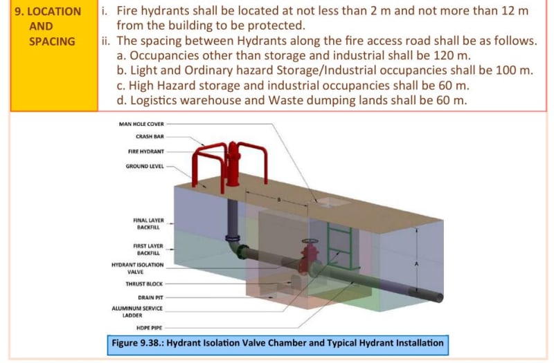

I used to deal with single project or building and applying NFPA standards only as you mentioned. nothing to deal with for Fire flow and everything related to hydrant is clouded in our area. except the private fire main having hydrant connected to our typical water supply (suction tank with fire pump set (E+D and J if any). Please check below as per our local code for spacing and hazard class. everything here is costly as hell! I've supplied many Aurora fire pumps typically shipped to us as fire pump set.
Fire flow will be handled by infrastructure authority as per the IFC Table annex B (properly) but I did not see anything physically conducted, all on papers only and not sure it's there or not and normally will not be conducted. so I'm totally ignoring this part. I've suggested them with residential sprinkler systems (only corridor I will be using QR spry sprinklers and other small areas) remaining is all RS. + class 1 standpipe automatic wet. this is my territory ^^
