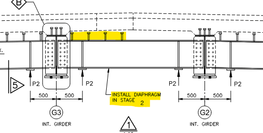

As for the cross diaphragms, in example 1 they installed the middle diaphragm in stage 2. To do this, they attached stud shear connectors to only one side of the top flange.
But since the elevation of the Stage 1 girders will be lower (due to the weight of the cured deck) than Stage 2 girders (before the deck pour), I wonder how they installed the middle diaphragm.
I don't recall seeing an intermediate diaphragm in contact with the deck and on the end diaphragms, where we haunch the deck down, we typically omit studs. Regarding your question, the steel would have (or should have) been detailed to allow the diaphragms to fit up. One side is kept loose until the deck is completed.
