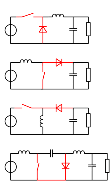

How long would inductor hold energy disconnected from battery but current flowed in alternate path
Robert Clark
Aerospace
Sep 1, 2021
19
Usually this question is asked in regards to just disconnecting the battery, like in the attached image. In that case the answer is just milliseconds. But in the analogous scenario for a capacitor, it could hold the charge for significant time because the charge would be held on the parallel plates as static electricity.
But it seemed to me there should be an analogous scenario for an inductor where the magnetic field persists. But for the inductor you need the current to continue to flow to maintain the magnetic field. So what about the scenario where the battery is disconnected by a switch but the switch then automatically closes an alternative pathway that allows current to flow, sans battery?

I’m informed that Buck-boost converters conform to such a configuration. Buck-boost converters are so common, the equations for such a scenario must have already been developed.
Note all versions of the buck-booster converter shown include diodes.
As soon as current is interrupted there is no longer an electromagnetic force to maintain the field, which instantly, for all practical purposes, forces the current to continue to flow. That is the function in buck/boost converters. Because it is forcing a current flow, it will generate whatever voltage is associated with that flow. Another practical use is generating the thousands of volts for spark ignition. The trade is the time - lower resistance = lower voltage and higher current.

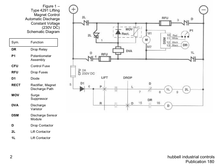

Inductors do store energy.
Lifting magnets can be particularly hazardous. Unplugging one of these without first turning the magnet power off will result in an arc flash across the plug connected to the magnet.
Mitigation is provided by a free wheel diode (resistance losses in the magnet eventually consume the energy).
If a resistance is added in the controller the energy will decay faster.
Hubble sells the line of lifting magnet controllers formerly sold by Euclid.
Selecting fuses for lifting magnet circuits is particularly challenging. The Euclid controllers include an energy dissipating device arranged so it can never be disconnected from the magnet. It is arrange to protect the fuses from the stored energy.
Yes, but this will also raise the voltage across the external resistor.
For example, if the external discharge resistor is 10 times the resistance of the coil resistance the initial voltage across the external resistor will be 10 times the applied voltage.
When a switch is opened, the resistance of the arc across the switch points rises very quickly.
Thus the "Kick Back" Voltage rises to a high value very quickly.
The faster the switch action, the higher the voltage.
Lifting magnets are a special case.
It is not enough to deenergize the magnet.
Small parts such as nuts and bolts are often magnetized by the lifting magnet and will not drop free.
A scrap lifting magnet is often energized with reverse polarity for a short time to "kick off" small objects that have become magnetized.
In the circuit shown, there is not the level of interlocking that most designers will use.
In the absence of complete interlocks, the Drop fuses are there to clear the circuit in the event that both the Lift and Drop contactors are energized simultaneously.
The circuit is an "H" circuit.
When lifting, the Magnet Coil, M is energized with M1 Positive and M2 Negative through contactors 1L and 2L.
When dropping the Magnet Coil, M is reverse energized with M1 Negative and M2 Positive through contactor D
The Discharge Sensor Module, DSM, monitors the decaying voltage across the Magnet Coil and energizes the Drop Relay and Drop Contactor when safe to do so.
