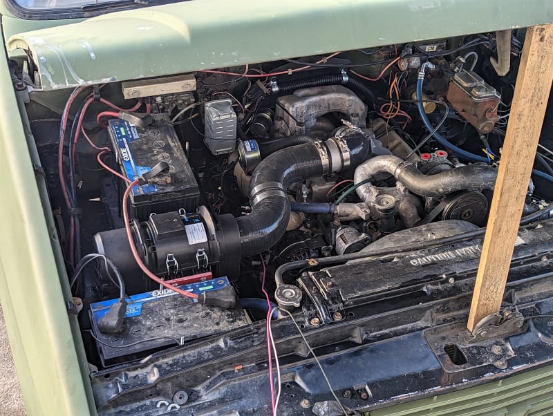

I turbocharged my truck recently. It's a diesel. I tapped into the the intake ducting for crankcase ventilation. This engine has a crankcase depression regulator but I don't really understand it's importance. It has a wire mesh type oil separator in the valve cover.
